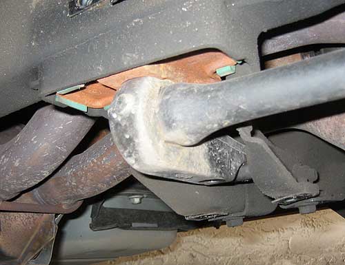

I know that the 97 adjusters have a Kevlar insulator glued to them. After inspecting my 98 for the common "clunk", I do not see any insulator between the adjuster and "pocket". I know when they wear, they usually squeeze out slowly, and possibly leave chunks in the skid pan. Also noted is that there are two different adjusters listed for 97 and 98 years. Fellow users on this forum have reported buying 98 adjusters without the Kevlar glued on-just plain forgings. So the big question, do the 98s have the kevlar, or have they changed designs.
Good question.
I don't think the 98s have the kevlar, they seem to have a pad that the adjuster sits in.
I didn't see any kevlar on mine.
Thanks guys...
Seeing as though it sounds like 98+ use a pad insert rather then a Kevlar patch on the adjusters itself. Would it be possible to have these inserts (Kevlar?) result with the same front-end clunk as 97- do?
