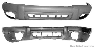

I believe they're called pal nuts or speed nuts. While looking for the chrome covers I saw pictures of the '00-'01 front bumper covers that had large triangular shaped holes there the fog lights go. IDK what that was all about. My '00 XLT had the same fog lights as my '01 EB, but only the EB has the chrome covers. I assumed the bumper covers were identical, but maybe not.

Note how in the above image there appear to be slits around the hole. Maybe the slits help locate the chrome cover and maybe there are pieces that snap into the slots?
Here's a RA image:
Okay, I've done it, the good is, it's not glued on, it does have clips and bend out tabs, plus three bolts holding it. You remove the bumper to install and remove it, which is a two person job, but once you get it off, it's obvious how to remove and install it, I got a used one stuck on right now, with a tiny screw on one corner because I warped it, but it's better than a big hole.
