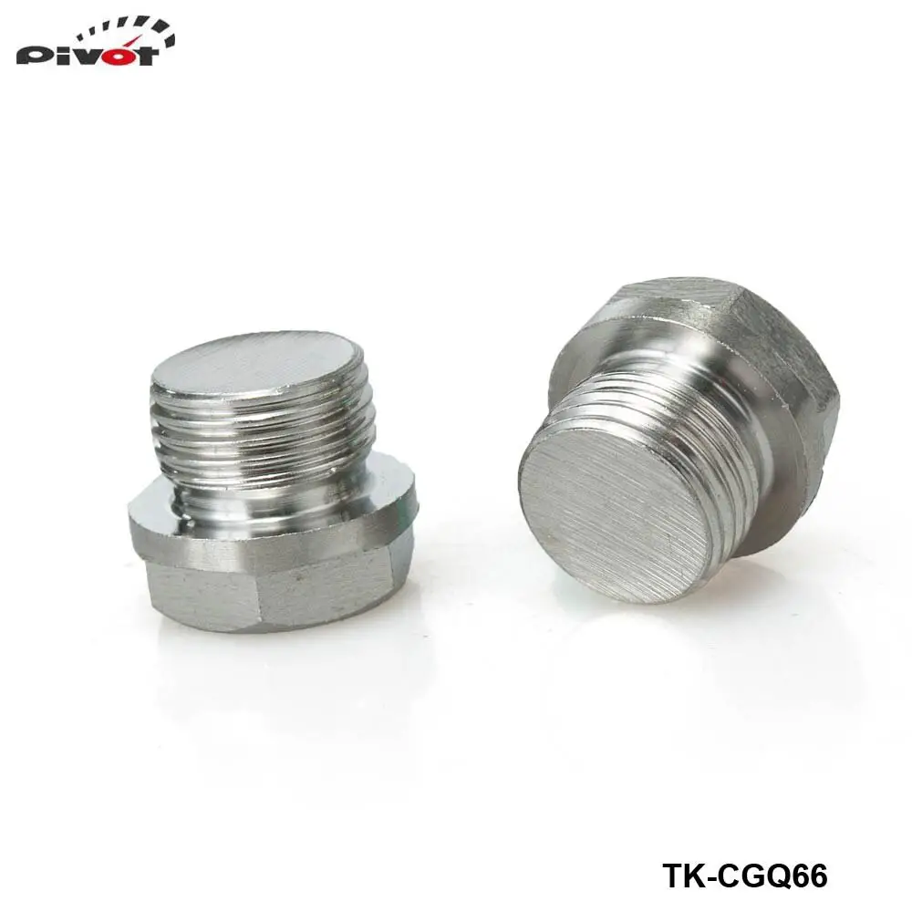

I checked the exhaust manifold and it was plugged with bolt. Like in this photo. And also there is no CAT converter installed on my truck.
You'll probably need to take your truck to an exhaust shop and have everything returned to stock (install cats and O2 sensors). It wont be cheap. O2 sensors aren't that expensive, but cats are and then there's the labor required.
