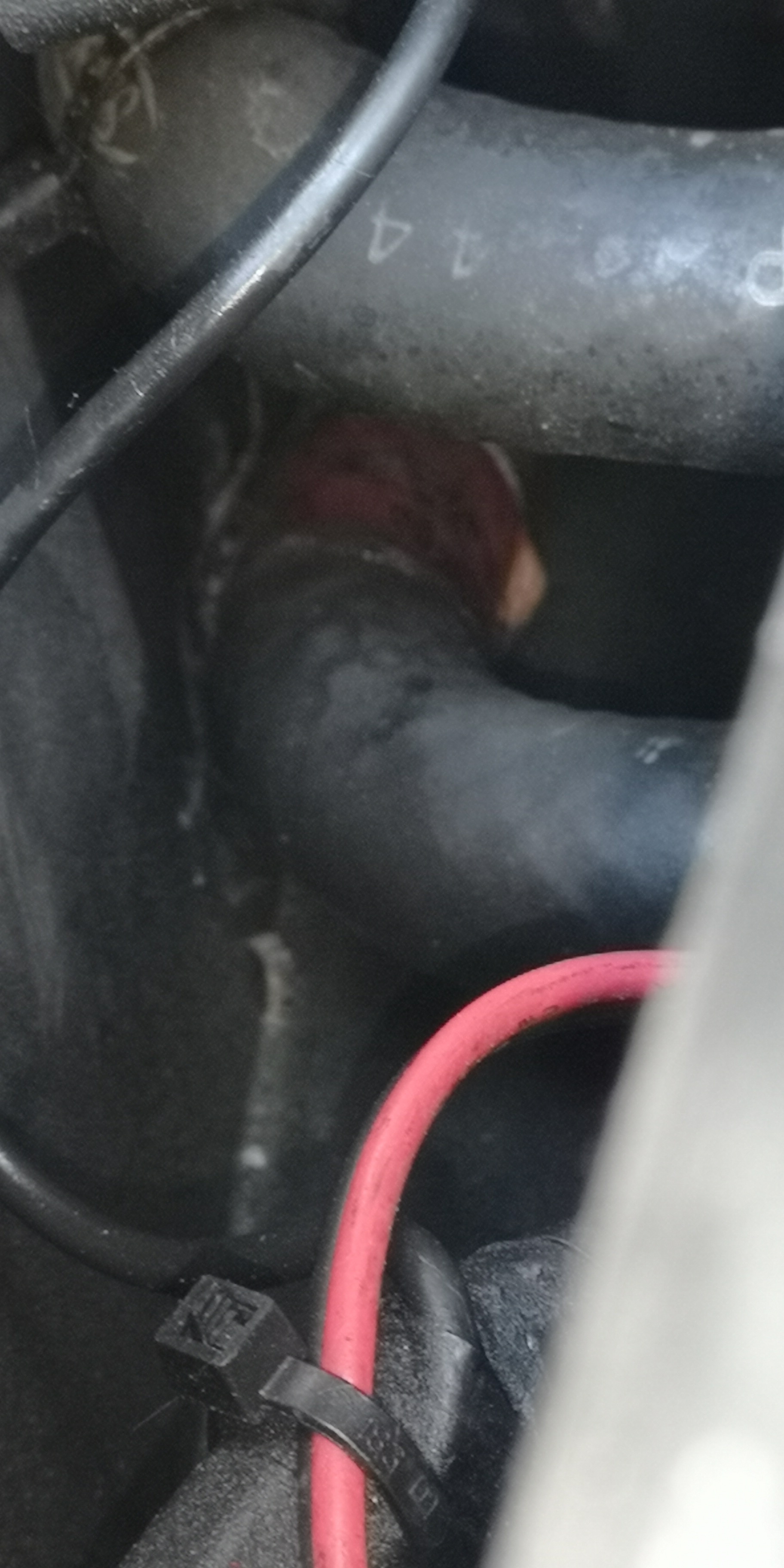

Can someone help me out with this hose? i just noticed a little leak yestoday...
Its really hard to see the hose, but its the one below.. Its a short with a 90 degree bend.
I cant find any on Rockauto,
It looks like hard vacuum line hose. Auto parts stores have plain black vacuum hose, and rubber connectors. You could use a rubber connector to repair the crack instead of replacing the entire hose.
