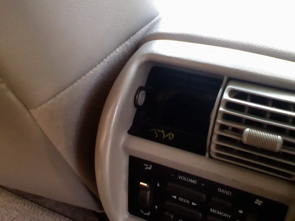

I'm sure I'm not the first person to come up with this solution. I'm not an Explorer expert but thought I'd mention this if it hasn't occured to anybody.
The center A/C vents on my 96 would not stay up. I guess from wear.
The easy fix was to slide a 15mm ID O-ring over the round peg (or whatever you call it) on the outer sides that the vents attach to.
Just pry the vents out with a flathead screwdriver, slide the o-ring on and pop the vent back it with the vent aiming all the way up. It provides enough friction to keep them positioned. Takes less than a couple of minutes and costs less than a dollar.
Works great.

OK here it is.

Yeah the driver's side center vent did that on me. My step-son found one me at the junkyard he worked at that didn't have as much wear on it.
The O-ring probably would have fixed that one as well because it uses the same setup as the rears.
