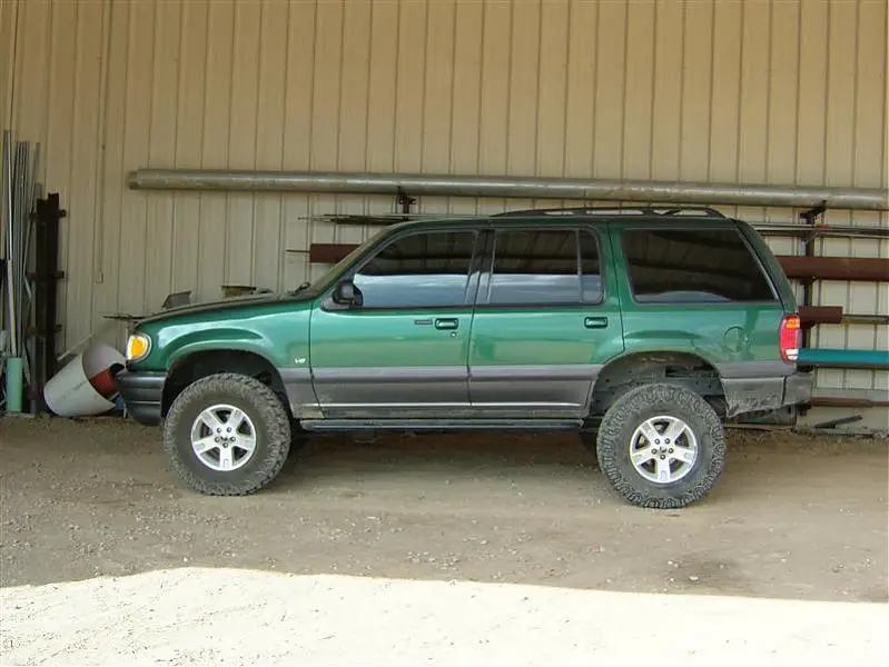

There are a few lifted black STs on here now :D
Nice truck! How much trimming have you done up front to fit the 35's? I need to get the sawzall out again on my day off next week. Did you have your bumper made or make it yourself? Few more pictures of it somewhere? And are you running 35's on 3.73's?!
I'm thinking about having a bumper made but I also like the clean look of the stock front end. I might just have a front hitch made to hide behind the bumper
There isn't too much trimming involved. The bottom few inches of the inner fender liners were cut off on the back side and some sheet metal inside the fender well (nothing that can be seen from outside) was trimmed. It still rubs just a little bit if the wheel is turned just right and the suspension is in just the right spot but nothing that I've worried about at all and nothing that chews up tires.
The bumper was actually on the truck when I got it so it wasn't me. Its basically a piece of steel C-channel that has been cut/notched/bent and gusseted to the shape shown and then the hoop added. I can snap some pictures if you want. I agree with a bumper that doesn't mess up the clean front end and that is one reason I like mine so much. It follows the curves of the stock front end and looks very professionally done.
And yes, I've got 35s and 3.73s. It helps that its a stick cause I think an automatic would lug too much. It really does need at least 4.56s but it is more then drivable as is. I even pull trailers regularly (not light either, heavy 5000# trailers :D). 4.56s are coming after the new year when I can afford them. Any offroading requires the use of lowrange. I pretty much don't use 5th gear right now unless I'm on perfectly flat ground or going downhill on the highway doing 75 or 80. It only turns 2000rpm at 70 if I use 5th :confused:
