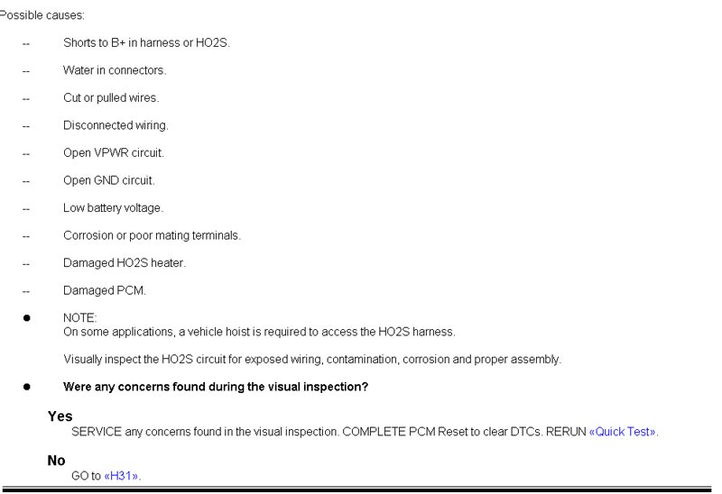

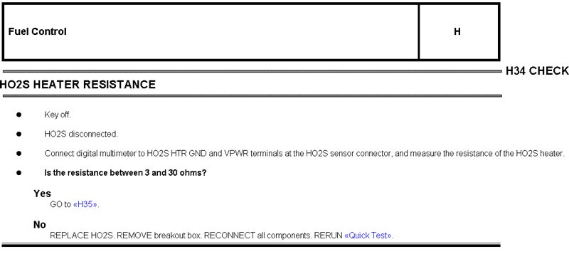

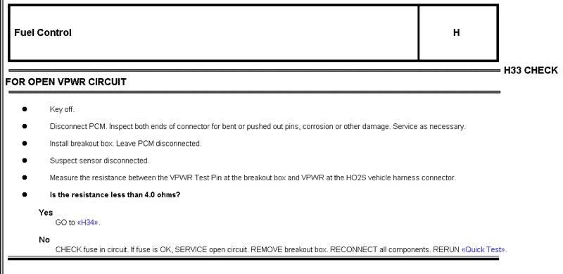

From the 97 Powertrain Manual
2

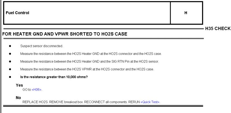

3
3a

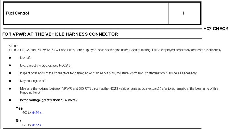

4

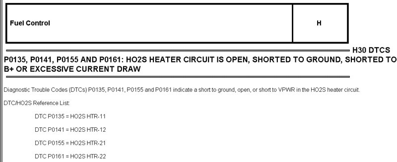

5

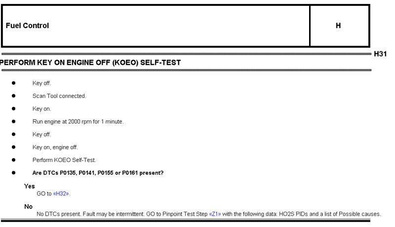

6
Its possible that you have a PCM problem, but I would check out all of the other stuff first

oops I forgot step 2

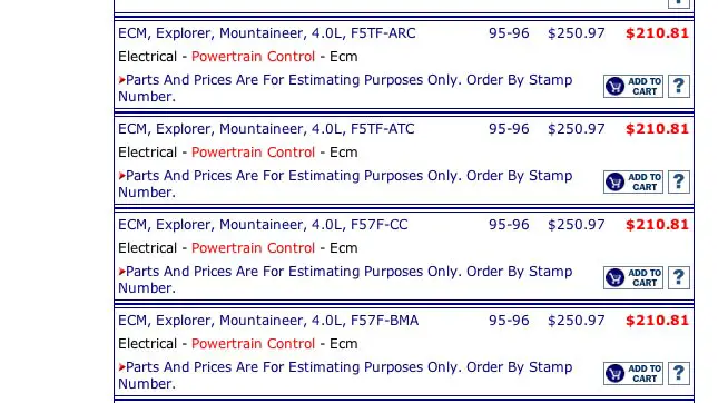

Where the heck do you find a new PCM other than the dealer?
fordpartsnetwork.com
