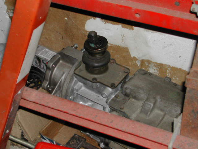

Few pics
Got a few pics... you can see the adapter on the back. It was tucked under our trailer, and i gotta leave for Fla...
This is what i could get for now.

Thanks for the pics.
Is the adapter just the short piece on the back or does it include the part in front of that with the shifter?
The adapter is the part behind the shifter, normally the tailshaft would be there on a 2wd
What kind of vehicle did you get the tranny from?
I found this pick on James duff website. It shows the adapter like you have on the left and the one I will need on the right. The one on the right has a shifter because the T-5 on a mustang loses the shifter when you take the tailshaft housing off to put the adapter on , so the adapter has a whole new shifter on it.
This clears things up alot. You must have got the tranny from a 4WD vehicle hunh. I know they came in jeeps at one point.

Yeah, my mistake... I do think where the shifter is, is also part of the adapter kit... Mine came from a 1990 5.0 stang
Does the T5 with the AA adapter change the location of the stick?

Yes the shifter location is moved forward quite a bit. Off the top of my head I would probably say about a foot.
