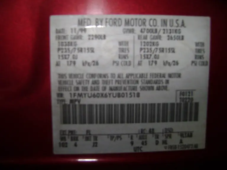

i just looked on the driver door. i found where it says axle. then right under that the number 45 is there. and from the chart it shows 45 is 45 ...... 3.55C. is that what i got? if so, thats a Conventional Differential? why does my other wheel spin at times?

can any one explain what some of the other codes on the pic are? i figure the wb-102 is the wheel base lenth. how about where the r is and under the r is 9? then under 9 is utc. nect to axle says tr with a d under it. then spr and hl. and finally at the end is 9ltab with the letter a under. sorry for all the questions :D just always been curious what all this means. any input is greatly appreciated! im guessing from the code the tr with the letter d under it is my trans? that means from the chart i got the A5LDE / 5R44/55E trans? i thought i had the 4R70W.

And that you have the 45 axle code meaning that you have an open diff with 3.55 gears
right. is that a good set up? open diff and that ratio?
Uhmmm, no. Each section is its own area. It lists specs for each different thing under thier own heading.
oh i thought it read straight down, not across.
oh i thought it read straight down, not across. because my truck is the first row.
