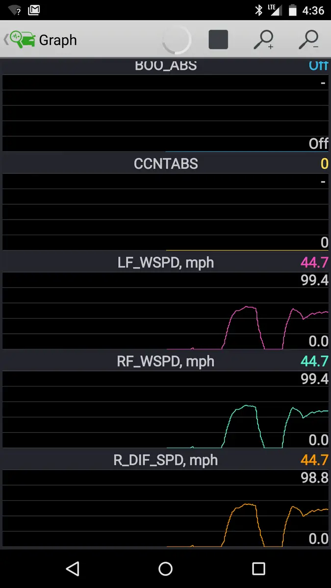

Got a chance to look yesterday. Forscan Lite let me see the real time PID values for each of the front sensors and the rear sensor.
