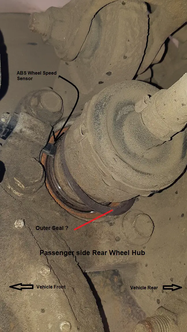

It appears that the right rear wheel speed sensor is slightly bend, the inner seal has split from the hub, and the metal has somehow migrated past the sensor (I did wipe down the sensor prior to taking the photo):

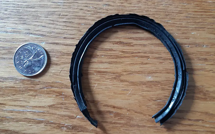

I also found the rubber seal wrapped around the shaft:

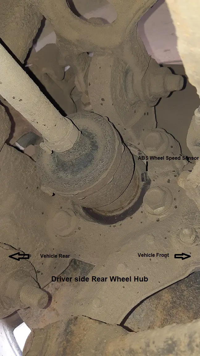

Here is a view of the driver's side rear hub for comparison. Aside from the dirt, everything appears okay to me.

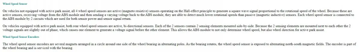

It appears that the encoder/tone ring is embedded in the wheel hub assembly itself. I came across the following in the Mitchell 1 service manual:

I double-checked the speed sensor - indeed, it is bent slightly. Comparing it to online images of new parts confirms as such. The wiring insulation from the sensor to the connector was perfectly fine, no pin-holes, green crusties, etc. and without performing any resistance, voltage or wire continuity tests, it appears that the source of the problem is the seal.

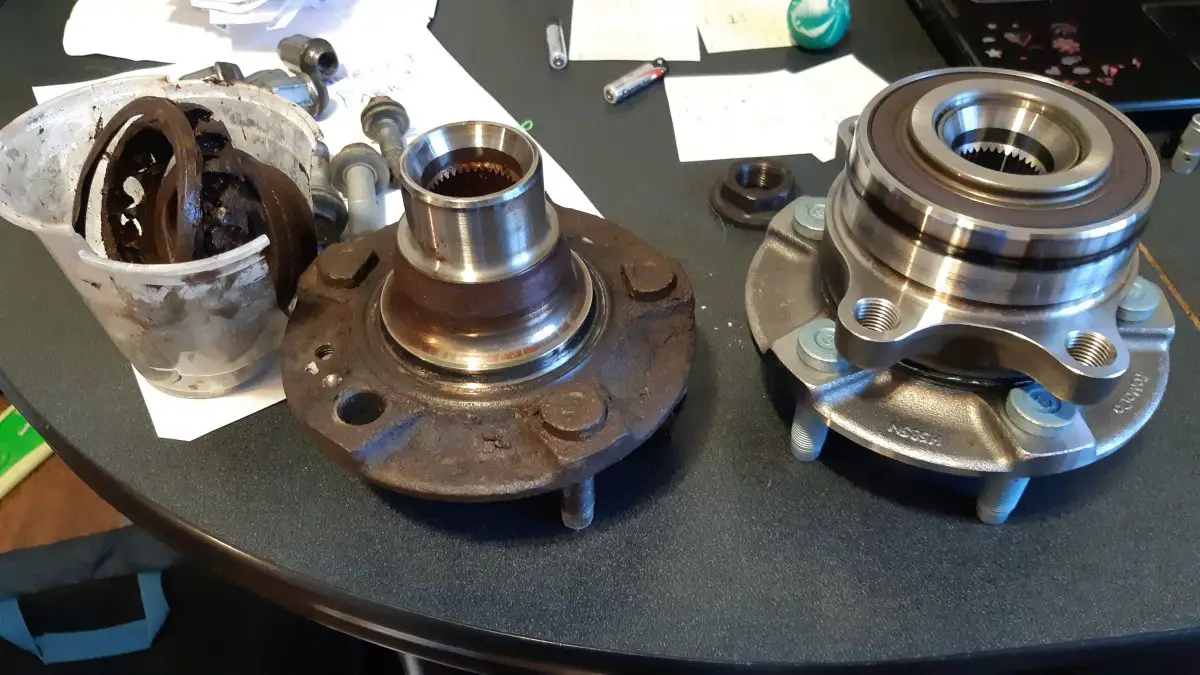

Onto the hub assembly - attached a hub buster (after cutting off and punching through 2 bolts to drive a couple grade 8 bolts into the knuckle). Using a 10 lbs sledge hammer I gave the buster 2 or 3 softish hits. No separation of hub from knuckle. Two harder-ish hits (not anywhere near give' it), something separates but not the hub from the knuckle!
It was the bearings from inside the hub that separated. Onto he ground. Into the dirt.

Here's an after pic of the former hub with its replacement.
