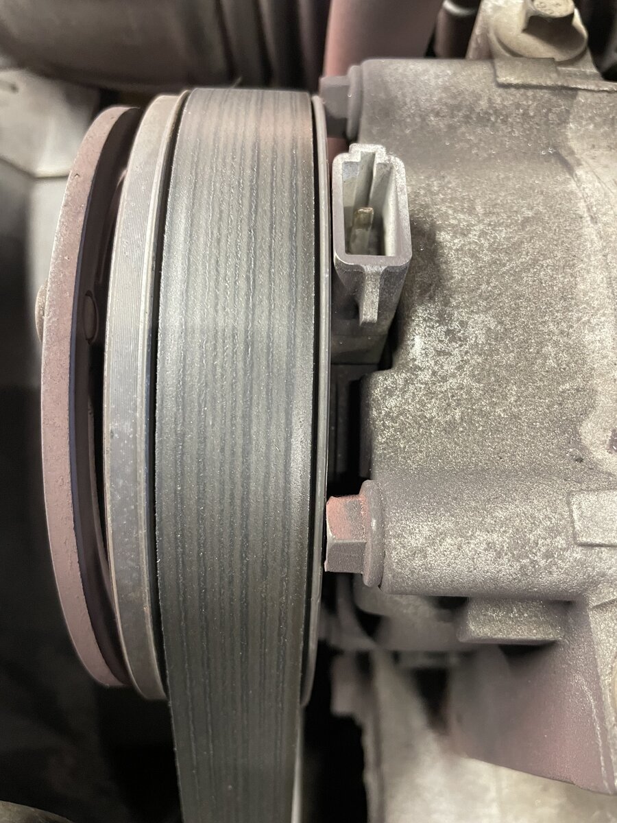

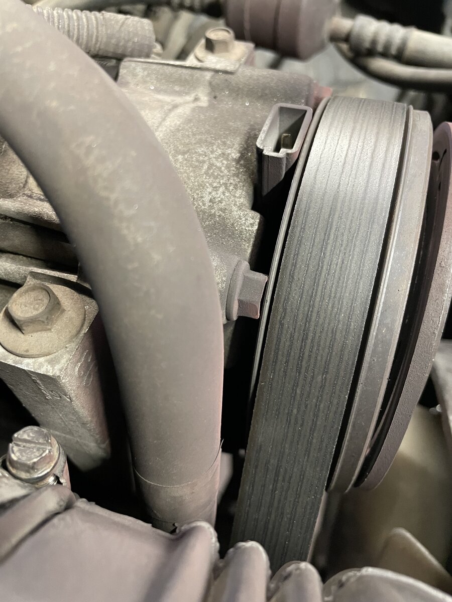

I've noticed noisy squeak from the AC compressor. AC doesn't work anyway, so I unplugged it thinking it was maybe kicking on during defrost. Still noisy, so I took a closer look. I wonder if the two upper bolts behind the AC clutch pully are rubbing the pully. Should they be touching like that? ....probably not I'm guessing! (also, shooting laser thermometer says 450F in that spot after a few minutes)
Try to fix it (pry bar?)? replace pully? Or, just delete it by replacing the serpentine belt with a non-AC length? ...AC system isn't charged.

That doesn't look right at all also there is a bigger gap on top of the clutch than the bottom so I'm thinking a pulley that is going bad and the bearing is almost gone I bet if you pull on the pulley you can move it back and forth which means you either replace the pulley/compressor or get a bypass belt
Thank you for that! Yeah, a gentle pry bar brings the pully out to what 'looks right'. Turning it back on, and the pully goes right back to rubbing. I think you're right-- that pully is shot. I'm going to get a bypass belt.

Replace the pulley clutch assembly. Easy repair

If you use your A/C you'll need a new clutch. The compressor will probably fail shortly after. It's the luck of the draw.
A new clutch will bring your belt alignment back. AC delete belts are a good option.

Given that the system doesn't contain any R12, and I don't plan to bring it back online anytime soon, I'm leaning to the "easy delete" solution of a shorter belt and just let an unplugged compressor sit there. My suspicion is that the whole compressor (not just the pulley) as well as other components of the AC system will all need attention when that project comes to the top of the list. I think fixing the pulley now might be putting good parts on to bad.

I replaced with shorter belt. Noise gone. Problem solved. Thanks! (I'll be back for the AC system in the spring!)
