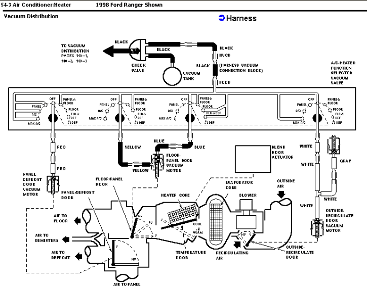

You have a vacuum issue. The mode controller that determines which opening the air comes out of is vacuum operated. When you lose the vacuum supply the default position is defrost only. There will be a small black vacuum line that comes off the intake manifold, goes to a softball sized vacuum reservoir inside the passenger side front fender liner, then connects from there thru the firewall to the mode controller in the instrument panel. Somewhere along that path the line is broken. Good luck.

And, also, plus as well, a vacuum leak anywhere in the vacuum system will cause a default to defrost registers.
Think EGR gaskets, intake manifold gaskets, IAC and gasket, other vac lines (there's only 3 or 4 of them), Etc...
