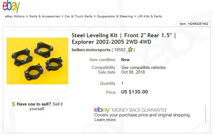

Do they make spacers that I can put on top of my quick lift to get a couple more inches of lift? I found some online but the stud pattern is offset on the rear spacers and complete opposite on the front spacers!! How would that work??

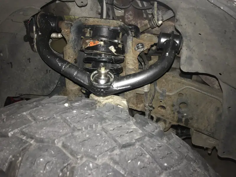

I'll be using quick lifts all the way around, plus strut spacers (2" of lift in the front/ 1.5" lift in the back). I also have BTF front uniball upper control arms for safety- stock ball joints would be really stressed with both, and have been known to separate- causing terrible accidents.

These are the spacers I have:

As far as the stud pattern, you simply rotate the mount on the strut 180 degrees.

I got the BTF control arms with uniball joints and they are great! Looks awesome too! Do you know if they make cold air intakes for the 04 explorer 4.0
BTF fabrication upper control Arms with uni-ball joints, Rancho Quick lifts and 2.5” spacers 2004 Ford Explorer! It handles great, does tend to need alignments more often and ball joints, but once the shocks got broke in she handles really well! Does any one know of any High performance transmissions,engine upgrades, andhigh performance rear differentials I could get that are compatible?
