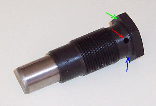

I used to advise members to replace the tensioners every 75K miles because the springs weaken with age. However, for the past couple of years members have reported that the new tensioners available seem to have weaker springs than the old ones being replaced. The springs provide tension on the chain when the oil pressure is low (i.e. engine start). The tension provided by the hydraulic piston is significantly greater than the spring pressure. Many members have cross threaded the bore in the cylinder head when installing new tensioners because of the spring pressure. Also, if not being careful the compression O ring slips out of position when tightening the tensioner resulting in a huge oil leak. Eventually, the piston constantly moving in the cylinder will wear and the clearance will increase which may reduce the pressure exerted on the cassette guide and the tension of the chain. However, I think the cassettes will fail long before the piston clearance matters. Also, if the cassette has already failed, removing the tensioner may allow the broken cassette guide pieces to shift to a position causing more damage.
My current advice is to replace the tensioners when the cassettes are replaced and not before. I also advise manually testing a new tensioner by compressing and releasing the piston while checking for smooth action. Some of the aftermarket tensioners are junk and will seize in the extended or retracted position immediately after engine start. If a tensioner seizes in the extended position the cassette guide will break. If the tensioner seizes in the retracted position the chain will not be taught and may slip causing valve/piston interference. The tensioner should be oiled prior to installation.
Squirt engine oil into the port identified with the red arrow and work the piston until it is well lubricated.
