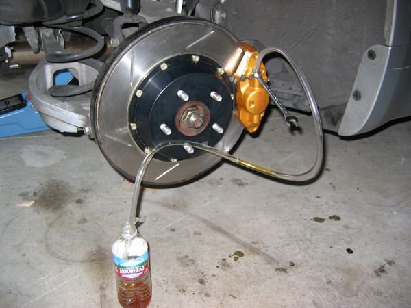

Another question is how are you bleeding them? Are you leaving the bleeder open as you pump the brake pedal, or do you close it before allowing the pedal to come back up? If you are using bleed tubing and a catch bottle make sure you arrange it correctly.
In this photo the bleed tubing is arranged properly, with the high point of the tube above the bleed valve. This prevents air from getting sucked back into the cylinder.
This photo shows how not to do it.
Gravity will pull the brake fluid down and allow air to rise up and into the cylinder.
