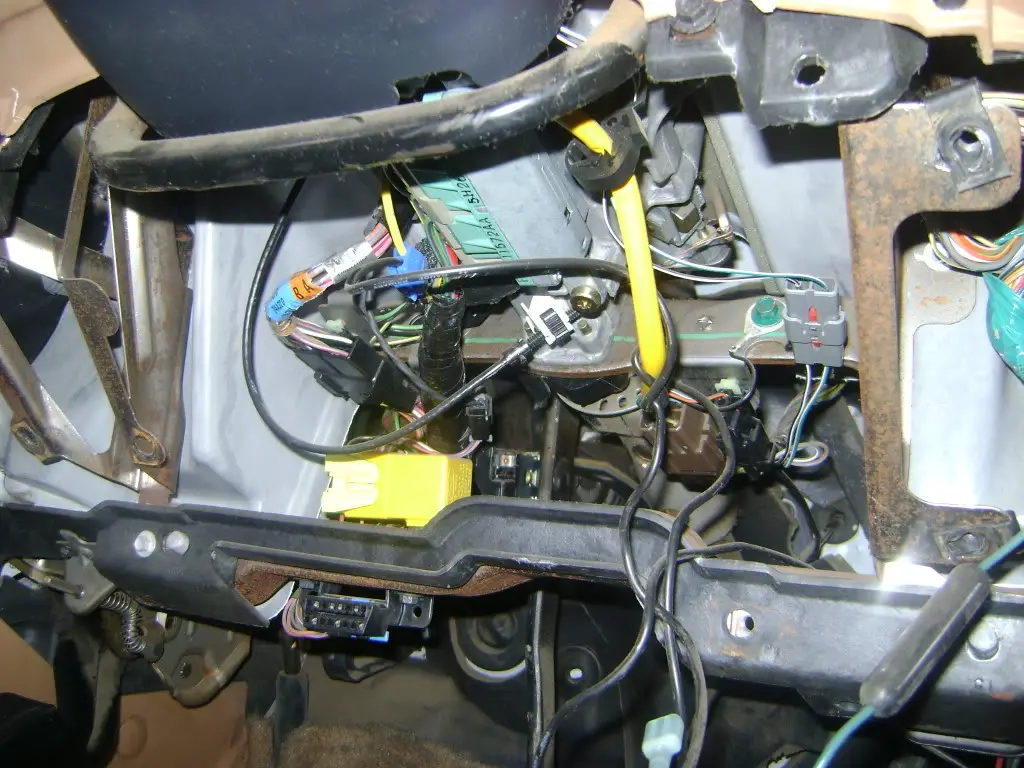

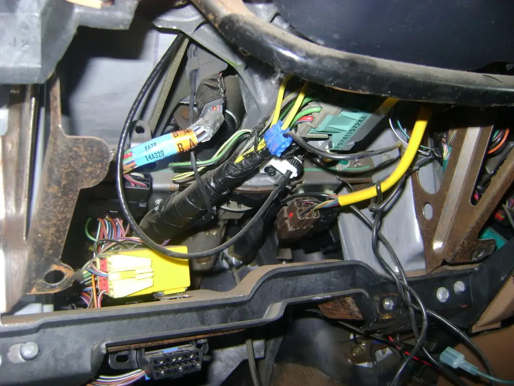

ok i didnt see anything out of the norm, i did find a green button tho, was attached to the lower part of the dash that i took off, never noticed it there befor, anyways played with it alittle, didnt do anything, tho when the truck was running, it made the truck rev ever so slightly when the green light flashed, so i have no idea wtf that is, i've put a few pics to show
Hey thor, what is that switch for? The reason I ask is that it's spliced into the ignition harness. Probably a constant 12v wire but that is kind of an odd place to pull power from. That has nothing to do with your issue, I was just curious. If there isn't an aftermarket alarm I'm not sure what you've got going on. It might be like bobflood stated, because the back hatch isn't locking it's triggering the factory system.
thats the thing im asking, i have no idea what that switch is for, other then when i have the truck running, and i switch it, the idle goes up and down like a pulse every time the green light blinks
