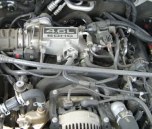

Sounds like the bracket that bolts to the intake manifold and alternator is missing. I have worked for Ford for almost 20 years, I have never had one break the alternator mounting bolts unless that bracket was missing. Sounds like it may not have been put back in place after the manifold got replaced.
[MENTION=280055]jpopper[/MENTION], I don't recall there being a supporting bracket for the alternator. I pulled the intake manifold off twice, replacing it the second time. That would make perfect sense seeing that it is the downforce of the belt pulling on the alternator that is making this happen.
Only picture I could find online.

There's also 2 sizes of alternator brackets supplied by Dorman (if this is your replacement intake manifold) one fits the mustang (and others) while the other is for the explorer.Make sure it's the correct one.
I have a bracket that came from dorman when I replaced my intake. I don't have a use for it if u end up needing it.
So after reading jpopper's post last night I racked my brain trying to remember a bracket. I thought, " if this hasn't happened before the first time, then there had to be a bracket on top to deter the downforce." I specifically remember telling my wife," I must have done it right, I didn't have any parts left over." Then I remembered my two sons, 8 and 3, were out there while I was working. I had all the parts on the ground in the order I took them off. I recalled finding a metal "U" shaped object on the garage floor a few weeks later and throwing it in my toolbox not knowing what it was. Apparently one of my sons had picked it and moved it when I wasn't paying attention. It was a year between the first time it broke and this time and I drive the thing everyday. Never even crossed my mind. Took the bracket by the shop today and asked the guy to wait till I was gone before he told his mechanics, " you won't believe what this idiot did..." Thanks for the help guys. This is why I love this forum. It has saved me hundreds of dollars.
