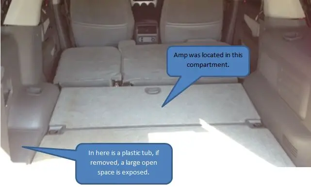

I have a non third row Explorer. I've since added a third row. This change has forced me to relocate my AMP.
Two part question:
A) If you have a third row and an amp, where is the amp located? (not the oe amp)
B) I thought about utilizing the storage compartment as shown in the picture. However, the power cord is not long enough to sufficiently reach. Can I extend the power cord (safely and efficiently) or must I run a new one?

I should clarify that I already have an aftermarket sub and amp. The previous owner had them installed.
My main question is about extending the power cable vs running a new one.
The cable you have can be extended, but I wouldn't recommend it.
Invest the $20 in a new wiring kit and sell off the other one. It's not the safest idea to crimp two low gauge wires together.

Thanks for the input all, I'll run new wire.
Peace of mind is worth a lot.
Yeah, I've decided to run new wire, just to be safe. I'm just at a loss on where to put the amp. I now have dual second row seats with a console and a third row. I could install a fan to help vent the compartment.
