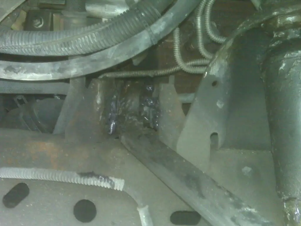

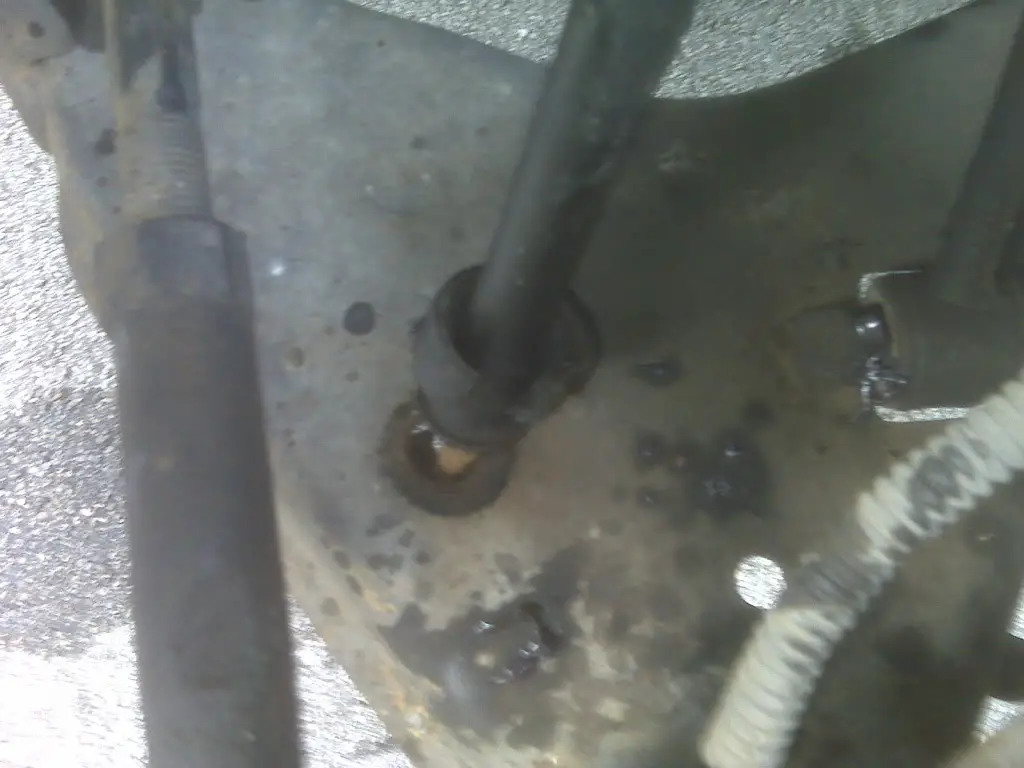

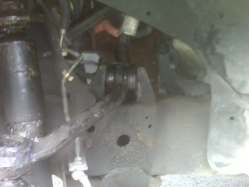

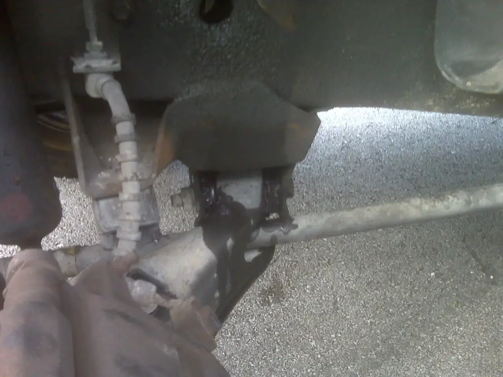

After hours of research and searching on explorerforums, I finally took into attempting to lubricate my X, (its a 1996 Exp LTD 5.0). It had the annoying squeak that you so often hear coming from the undersides of late model fords.
The noise mine was making was occurring while going over a bump / or a change in the road surface. It also would happen if I pushed down on the hood (as seen in the video) , or closed the door LOL.. So after lubricating all the parts others had spoken about, I had no luck. I Have posted pics of the parts that i lubricated, The only thing i didn't do is drill a hole into the top of the ball join and lubricate it. I have heard success stories from others on here who have done this. And yes I agree its not the ideal way to go, but I am a poor college student so cheap is best for me:) If I am wrong about what parts I mentioned please correct me, Suspension systems are confusing to me :(
So please find attached the pictures of the partsi have lubricated, I believe the first two are the upper control arm bushings.. The second two are the lower control arm bushings. The fith is the upper ball joint, (loaded With Grease). And the sixth is some part that's broken? it looks like its supposed to be attached to something at the top but its not and the bottom part has come out as you can see, Its not rubbing against anything so I don't think this is the culprit. Just curious what part it is.
I have also included a video so you can all hear the noise, there is a similar noise when I turn the steering wheel but only at the last part turning circle as you can see and hear.
I did lubricate the lower ball joint but not using the drill method, If anyone has any ideas of what part to lubricate next.. Or did i Miss something, that would be great.
Upper Bushings ( I Think)
Lower Bushings (I Think)
And The Broken Bit
mine does that too, on the passenger side,, put it up an a jackstand, take the tire off, and check the upper and lower ball joints, ,
mine has got to be a ball joint, and they are not greasable,
Yeah that's what I heard, but I also heard that there is a temp solution of drilling the top of the ball joint and inserting a grease nipple, and then putting grease into the joint via the nipple. And of course sealing it afterward. I wonder if I do that it will solve it at least till I can get them replacted
when it happend on mine it was the upper control arm bushings. but with all that greese you got in there I would hardly think that is the problem with yours.
I would suggest net time use WD-40 to diagnose squeaks, because it is liquid it will penatrate deeper and qive you quicker results than waiting for the grease to settle in. do one joint at a time till you find the right one, Then you'll know what to replace.
But it will only fix the squeak for a couple of days at best....
Let us know how you make out .
Well I did actually use WD-40 on all the brushings and ball joints, but no luck. So Im going to go with you and say that its probably not the bushings. :( So time to approach the ball joints :(
Anyone else have any ideas..
