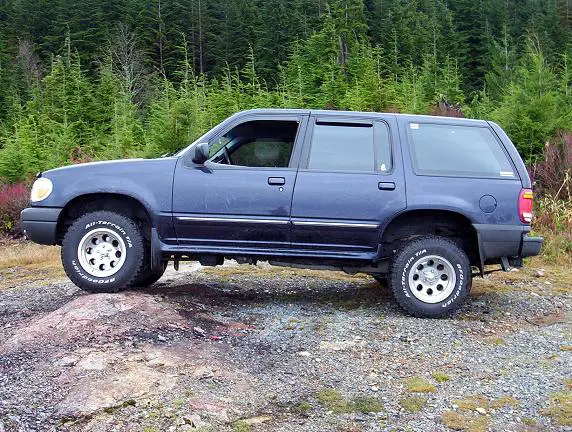

Here's mine back when it just had 2" TT WAR-153 shackles and the pro-comp AAL. It sat level but I can't find a shiny driveway pic.
Ride was a bit stiffer than stock and I continued to use the stock shocks though I later upgrade to Monroe Reflex's which are now dead and awaiting replacement. Thinking Rancho 9000's this time around.
Tires are 30x9.5
