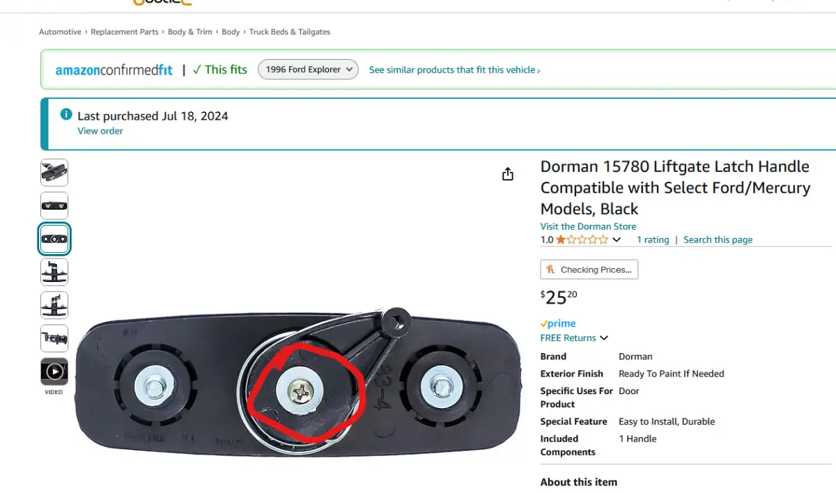

Turns out the handle ALSO needs a bolt on the reverse side, to hold the arm onto the handle post. Product pictures show this screw on the handle. It is not there.

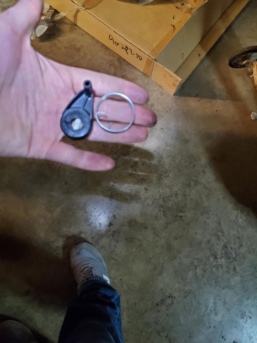

Handle arm and spring, after fishing them out of my hatch:

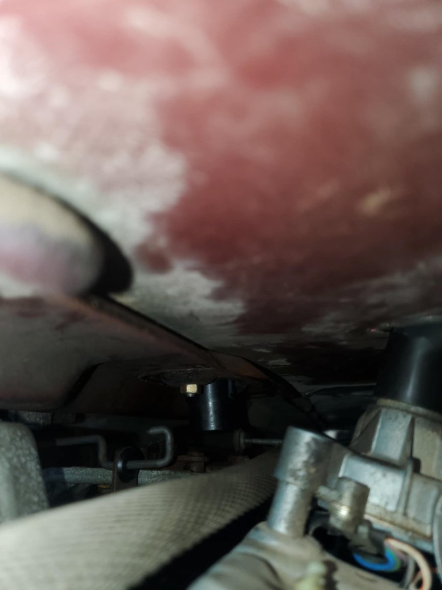

Bare handle post poking into the hatch (took a bunch of pictures while making sure there weren't any extra pieces missing):

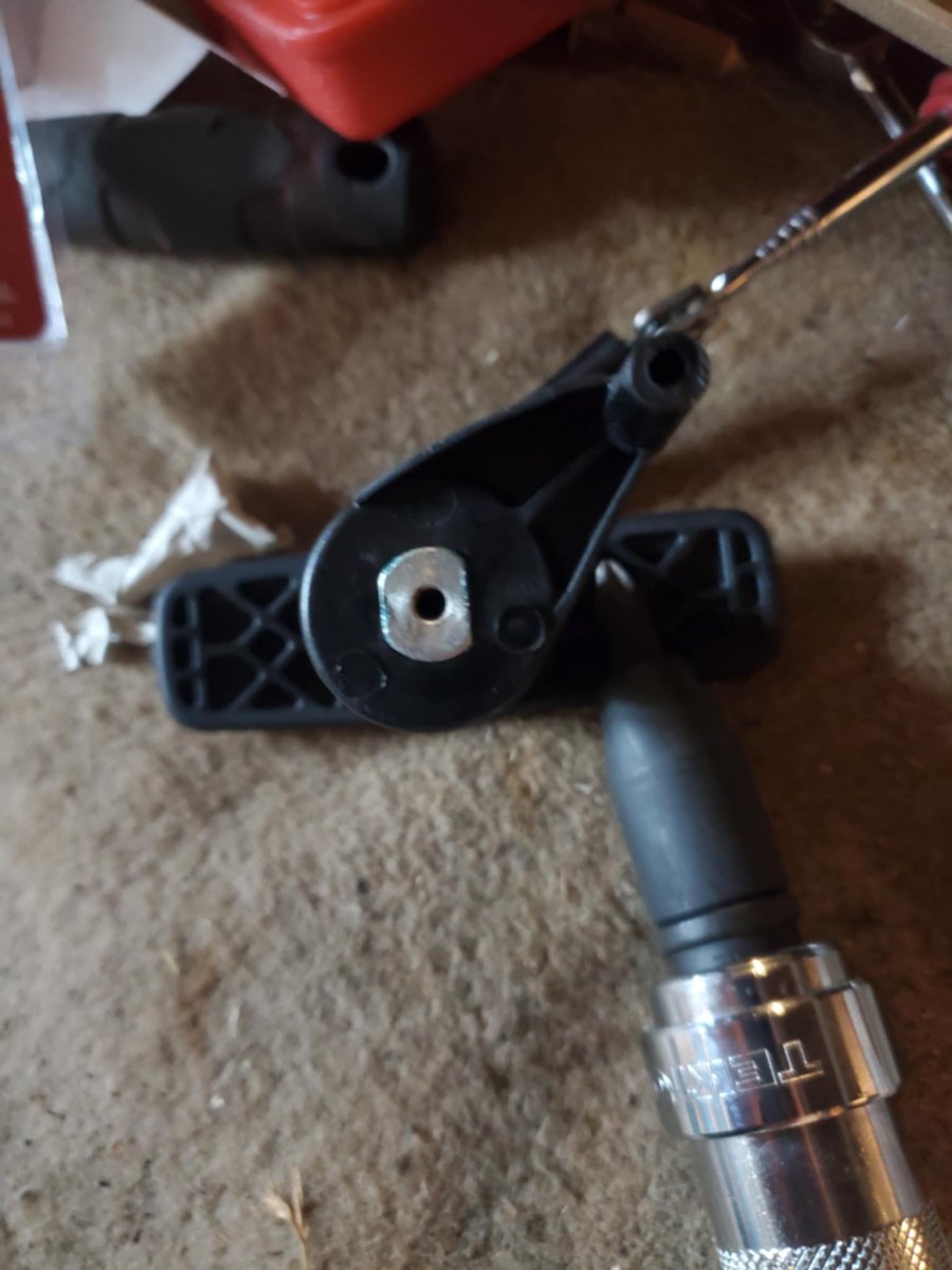

Arm on handle post, as it comes in the box (reassembled after fishing all the pieces out, to make sure I wasn't crazy and nothing was permanently broken):

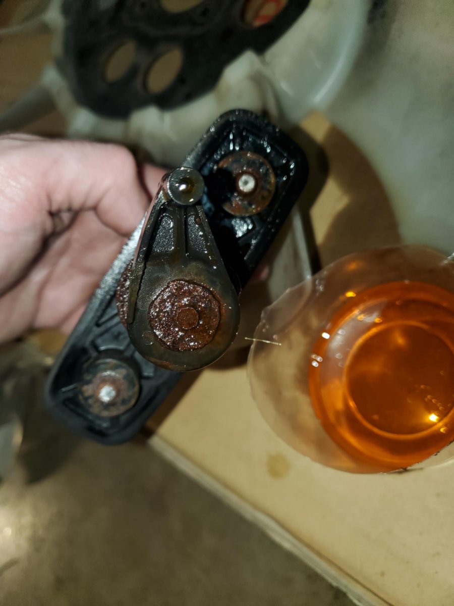

Old OEM handle WITH the bolt that holds it together:

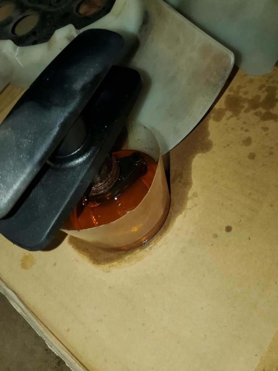

Old OEM handle soaking in some penetrant oil, so I can hopefully get it out of there and buy a new one:
Again, the Dorman product pictures include the screw that holds the wiper onto the handle post.
The product does not come with this screw.

Their response is a lie. The screw (circled in red below) is visible in product photos 3, 4, 5, and 6.
