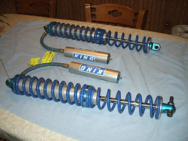

I just started swapping in an EB d44 into my 90 Bronco2 and I have a set of 12" King coilovers Im going to use. I was just wondering if anybody else has gone the c/o path so maybe I could see some pix or get some tips before I start cutting and welding on mine.
Mine are 12" 2.5 King remotes with 200lb over 300lb.

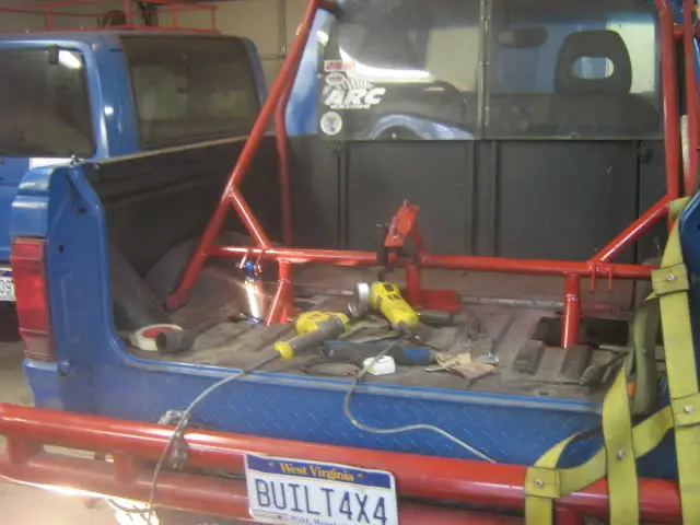

BTW, Rookie.....have any pix of your core support? I was thinking of doing the same thing!
This is all I got. The top support swivels up to release rad. Or top support can be completely removed so engine just pulls straight out once rad. is removed.
