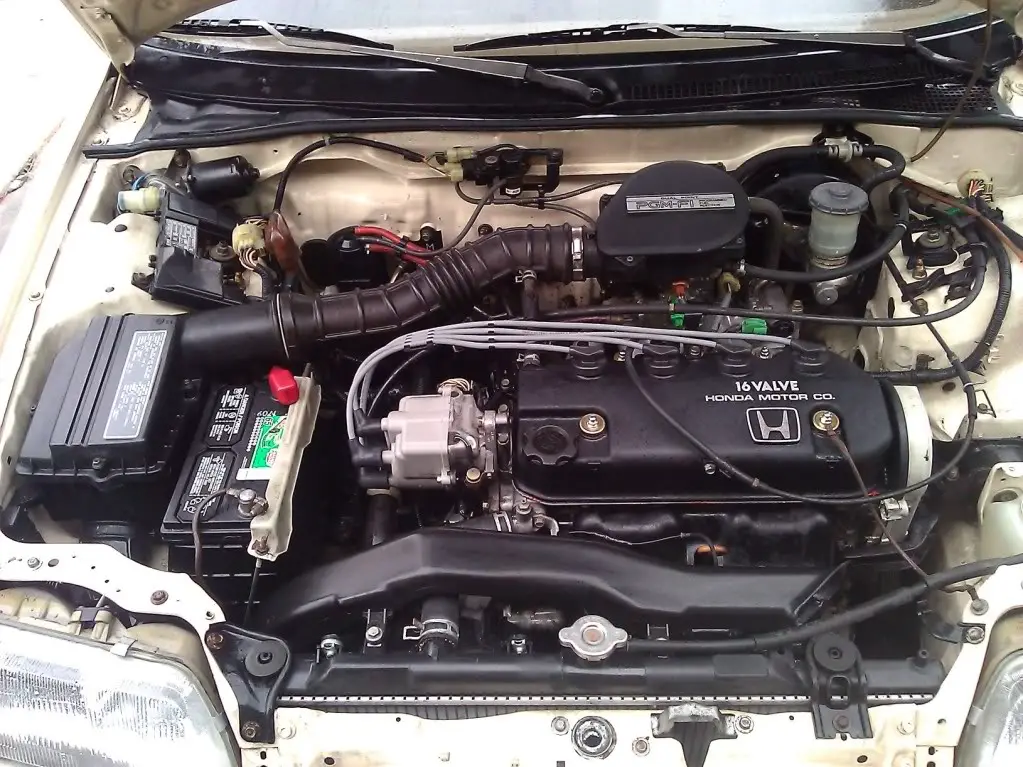

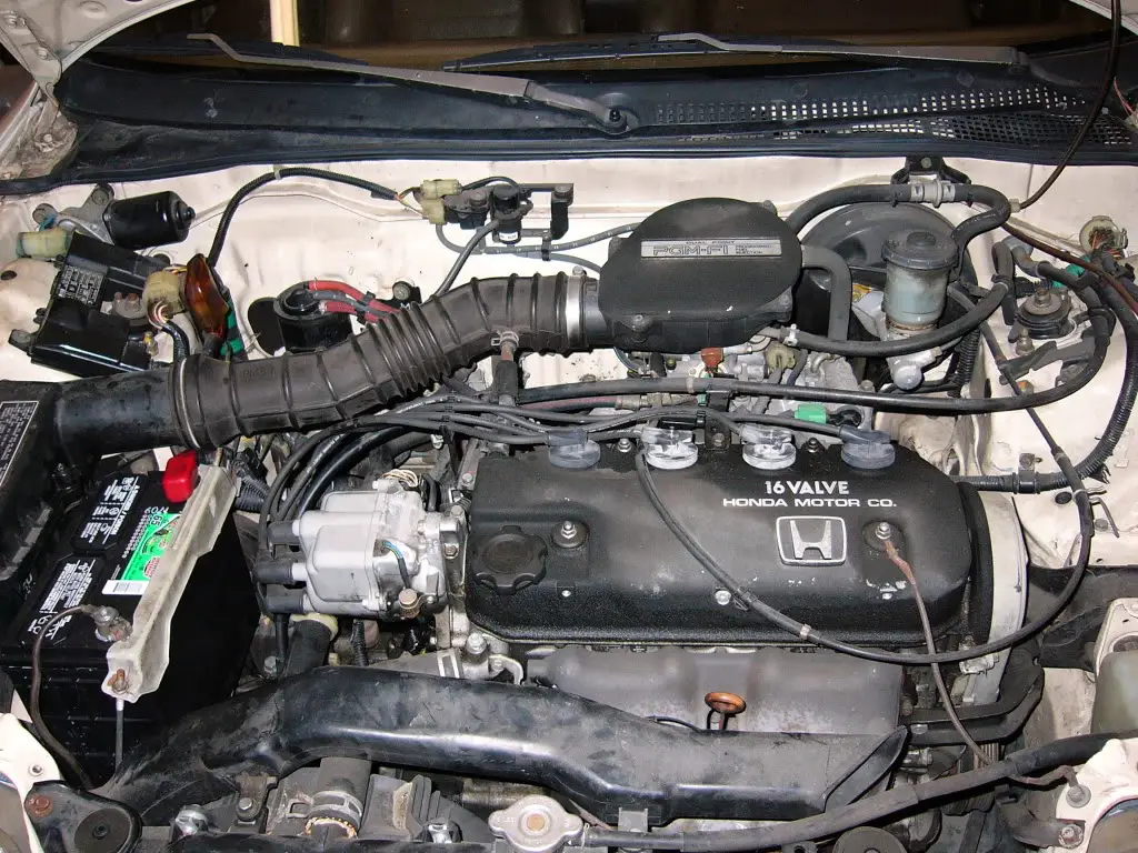

i dont use thw wd-40 on the rubber parts, but for the underside of the hood, and the engine bay. squirt, and then wipe with a towel. it workds, trust me. ill show you some before and after pics once i get to my laptop.
here's a before and after of an old civic i restored (not raced out!). all that was used hear was engine foam, wd-40 and a little spray paint on the valve cover.
