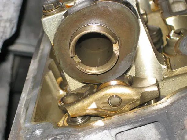

Hey guys. Trying to see if anyone out there has a picture of what the right camshaft on a 4.0 SOHC looks like correctly timed when the cam timing slot is horizontal to the head mounting surface?
I'm curious where the camshaft lobes are when it is in the correct position.
I find it hard to believe that I put the camshaft in wrong (I was trying my darnedest to keep it in timing when I was installnig the rockers) but who knows at this point:(
Thanks!
Cyl #1 cam position
I'm not certain but I think this photo is of cylinder #1 (front, passenger side) with timing slot correct and piston #1 at TDC on compression stroke.
