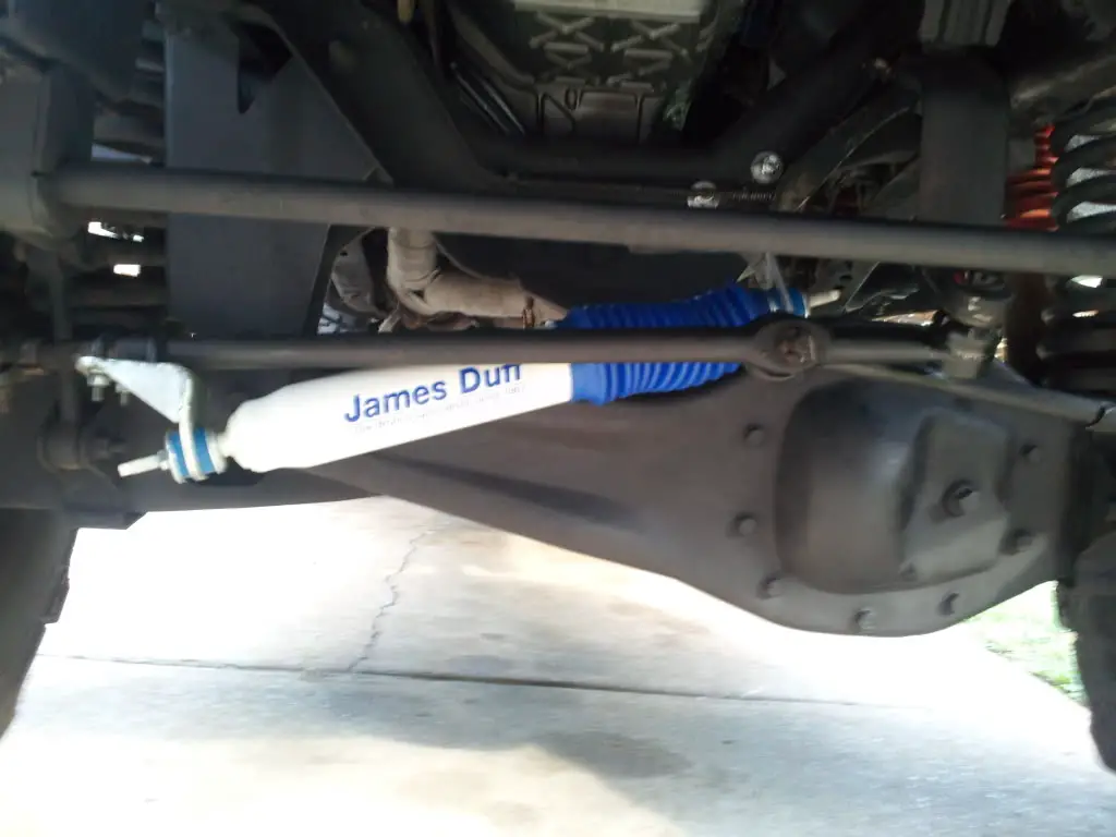

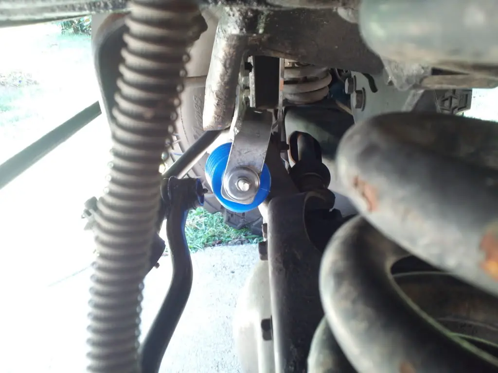

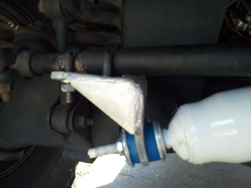

i figured mine out.i just flip the bracket around that mount on the crossmember and bent it a little for the new angle.its real close but works for now.ill see if it rubs 4x4 ing this weekend.its the fa 600 arm that mess it all up.
If it works please post here. If you had a pic to that would be great.
its works for the street just fine,just need to see if under flex it works.ill post pics.going out this week end;)
pics
the bracket thats attaches to the cross member is flipped around then bent out a little to clear the pig coming up.the one on the arm is bent a little to help with the angle.it clears but a full right lock it comes very close to hitting the bolt head in the passenger side drop bracket

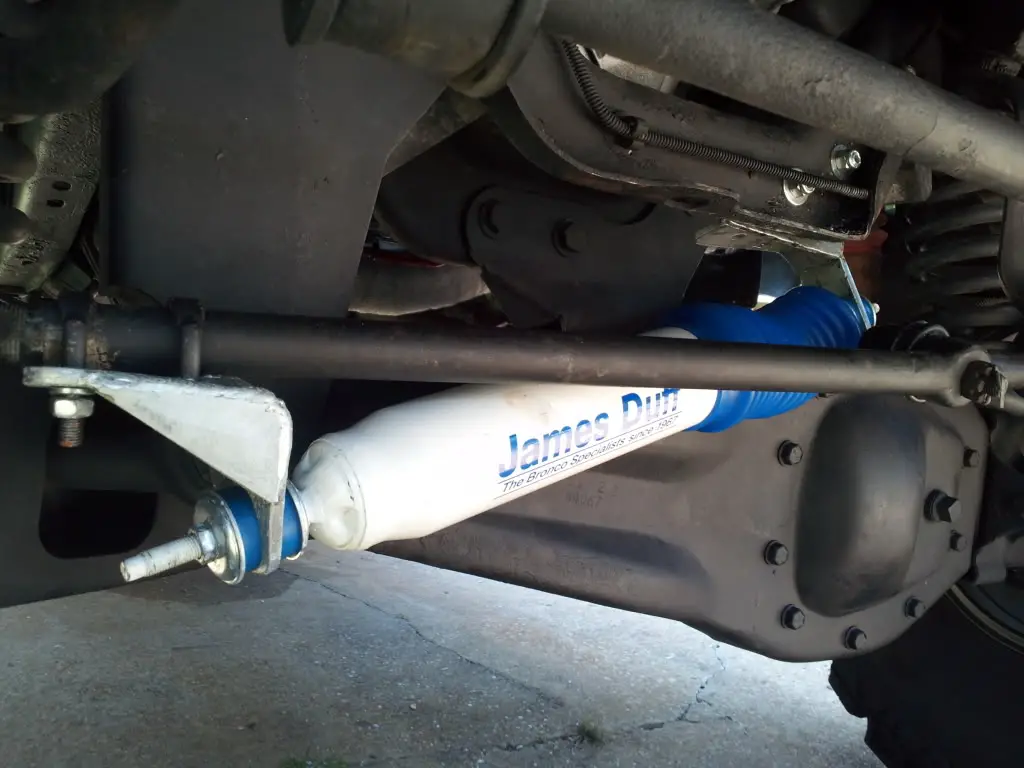

I just noticed it looks like I installed our steering stabalizer with the brackets the other way around compared to what is pictured above.
Here is the best shot I can find of ours. We are using a rancho steering stabalizer and I think the brackets are rancho also. I got them via amazon.com
steering-stabalizer by maniak_az, on Flickr

mine would not install the way it tells you to install it.it would not fit at all and if i flipped it around the way you have it,it would take up even more room.if you look at the bracket that mounts on the cross bar you can tell how i mounted it different.
