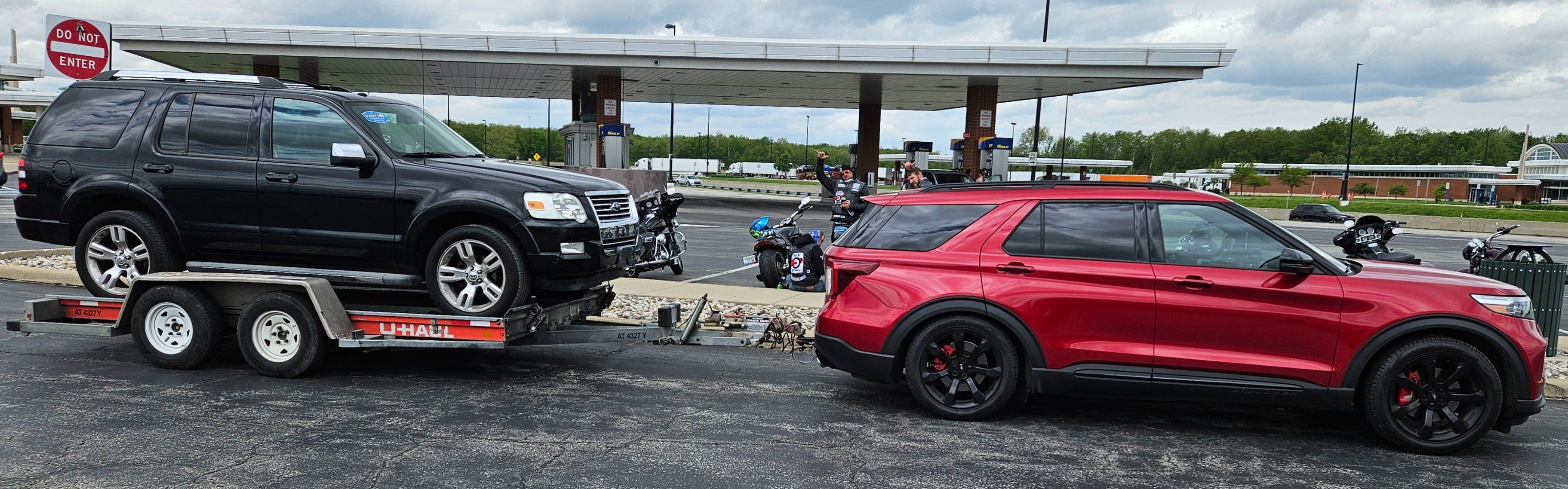

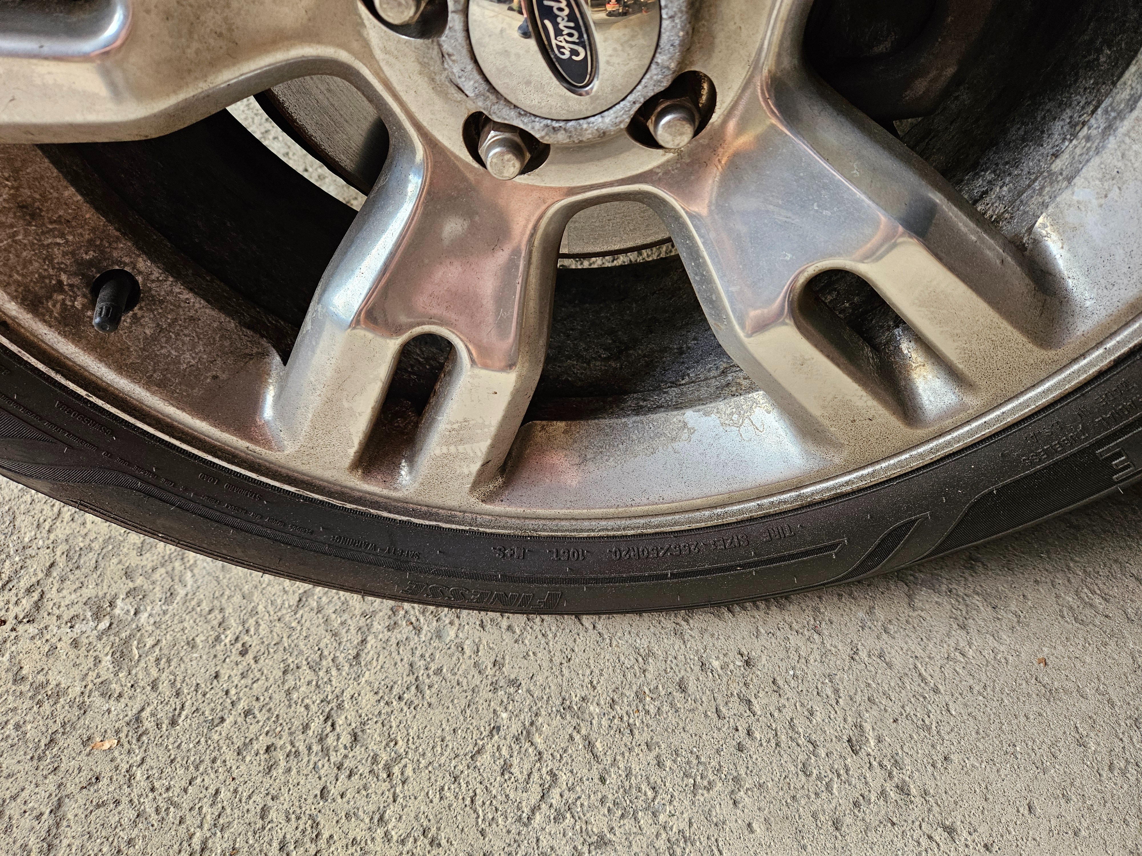

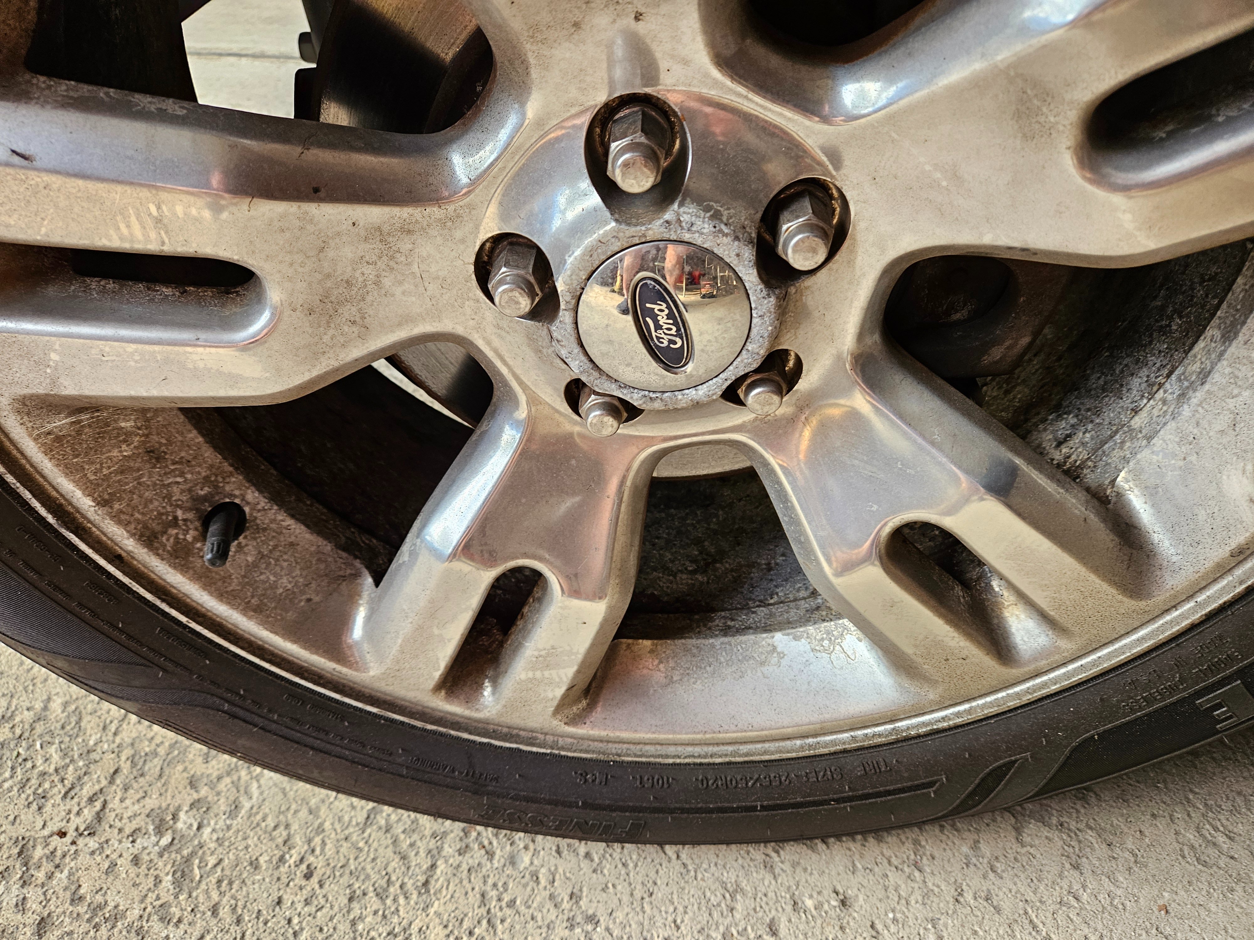

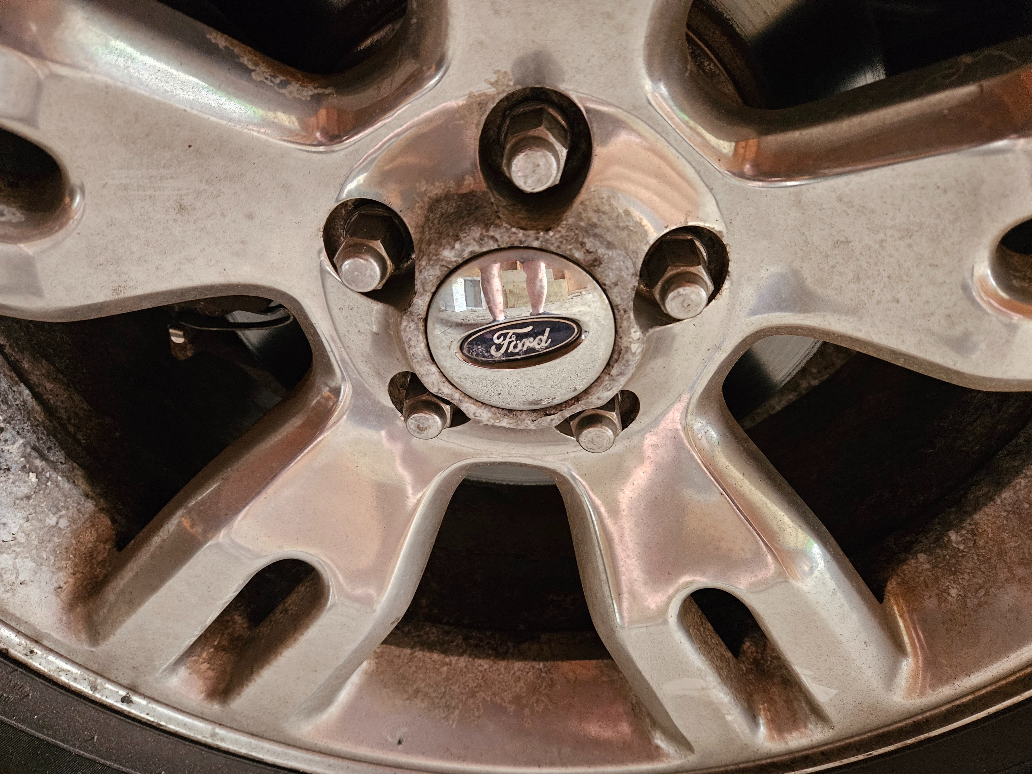

It's definitely a 30 footer, you get up close and the wheels are in bad shape.

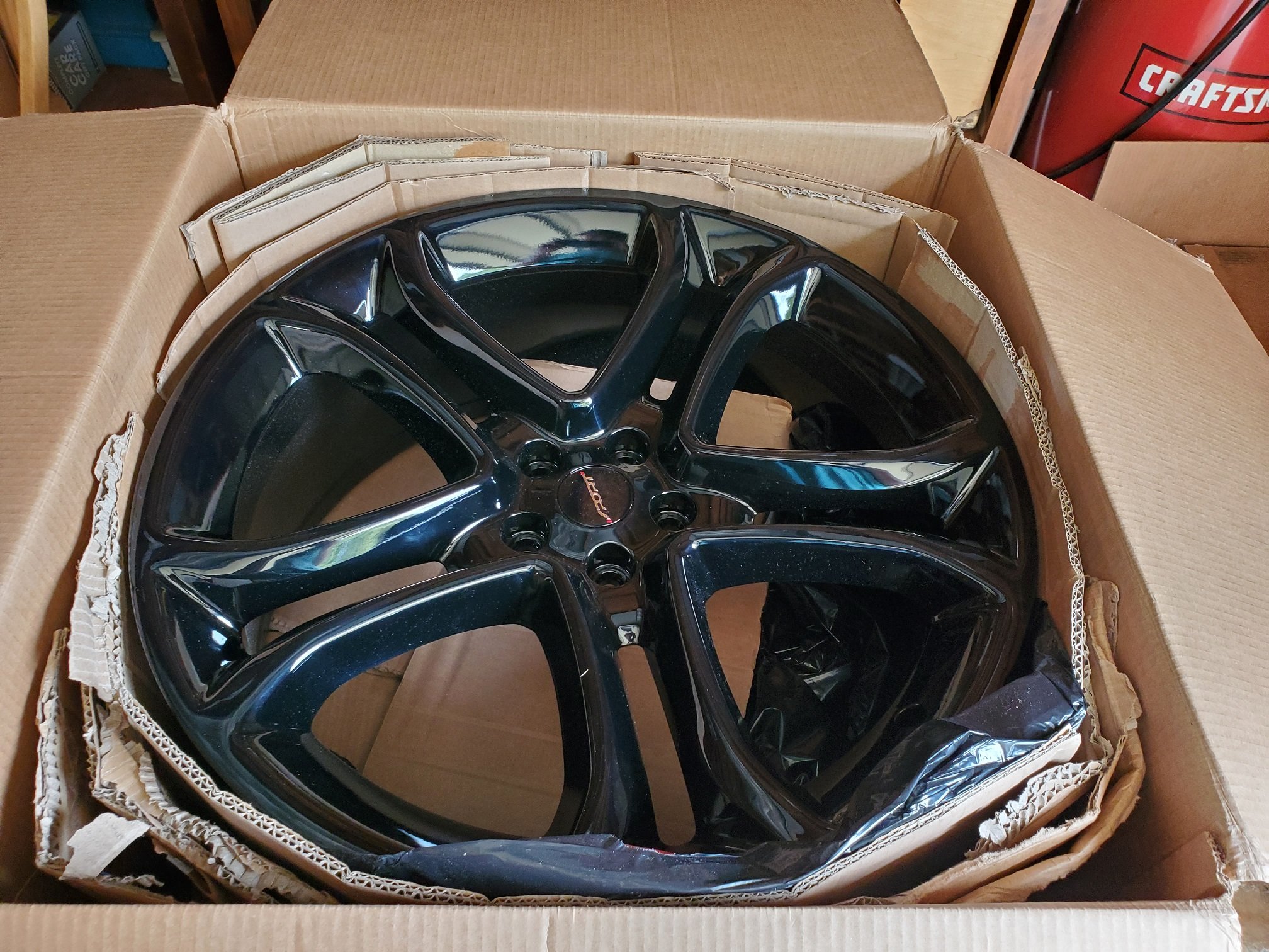

I have the same rims that are in a little better shape. I plan to have mine painted or powder coated. To have them mirror polished and clear coated is to costly for a 15 year old vehicle with over 150k miles on it. It is definitely not a garage queen.
