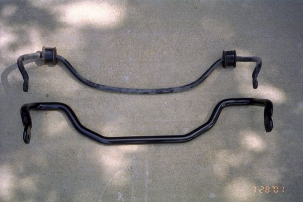

On your truck, you will need to upgrade BOTH the front as well as the reat. Your front bar is hollow.
I recommend Explorer Express as the source.
My handeling improved vastly with my bar upgrade,
Further, bw sure to go with poly bushings,
You will not need the split collets unless you are lowered.
Good luck....
Take a look....
Collets are clamps on the rear bar that limit lateral movement to prevent the bar from hitting the leaf spring on lowered exploers. That also tightens up the back end a bit.

stock
front = 23 mm = 0.906 in
rear = 16 mm = 0.630 in
explorer express
front = 34.925 mm = 1.375 in
rear = 22.225 mm = 0.875 in
addco
front = 28.575 mm = 1.125 in
hellwig
(all three kits come with urethane bushings)
proportionally, the explorer express bars increased the same. if i'm not mistaken, the X will react the same with less body roll. the addco and hellwig both are identical in size. they increased their rear sway bar but not their front sway bar as much, which would allow for more oversteer. doesn't that setup seem more beneficial for the X? keep in mind that my X is a city delivery truck. any other recommendations or suggestions?
