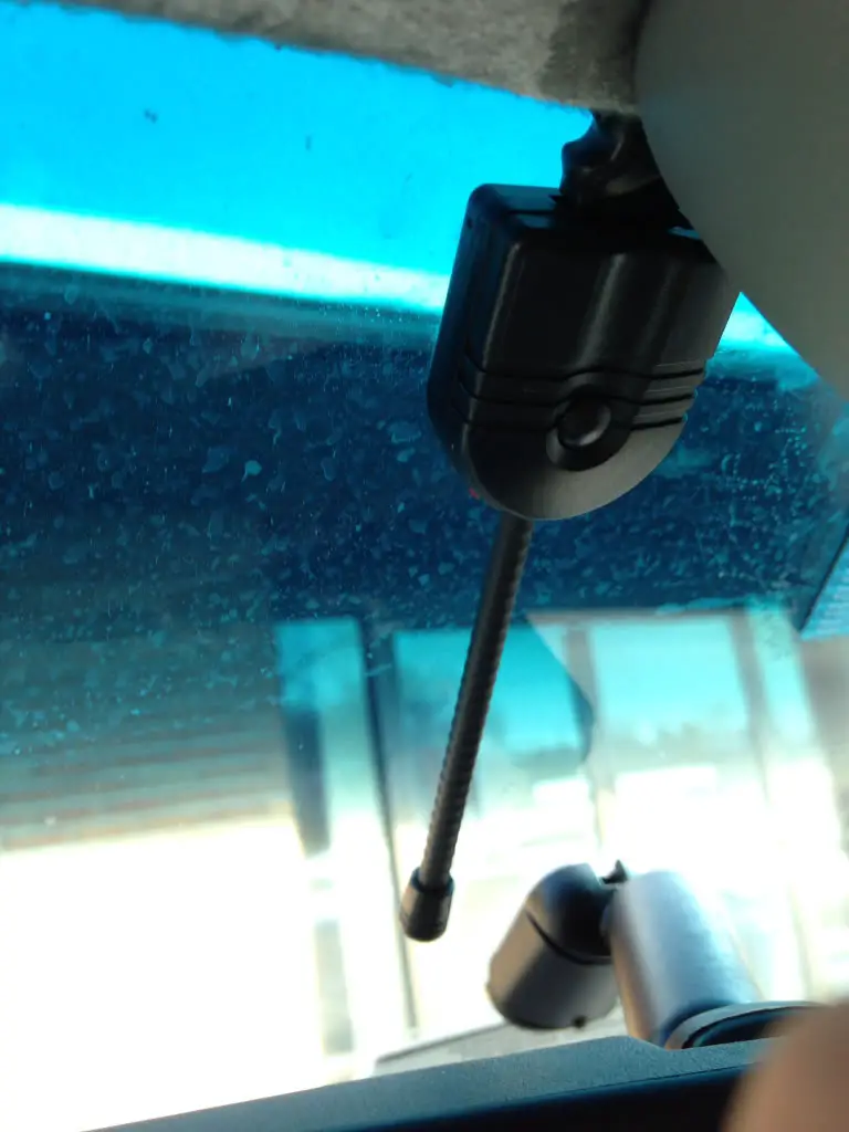

Anyone have an idea what this is? Small Antenna mounted just above rear view mirror. On my 2000 XLT. Has a small button and a red led. Looks aftermarket.

It's an aftermarket alarm antenna. For sure. The button is the valet switch.
If you trace the wiring, it goes towards the drivers side, down the a pillar, and under the dash, where it's tapped into your ignition/etc.

After I looked online to see what DjDom mentioned, it does look like one. I have never heard of one, or have seen one.

it's part of a remote start/alarm system, it's the valet mode, but, when programming the remotes you also have to push that button, probably a $500 touch

It has to be an alarm/starter/keyless system.
If it were a radio antenna or a booster, it wouldn't have the button on it.
