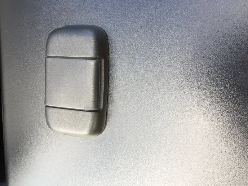

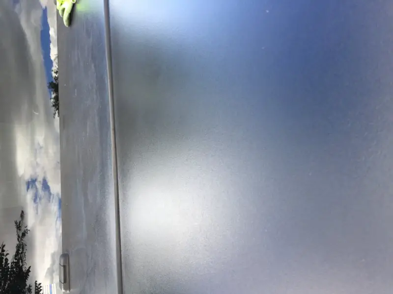

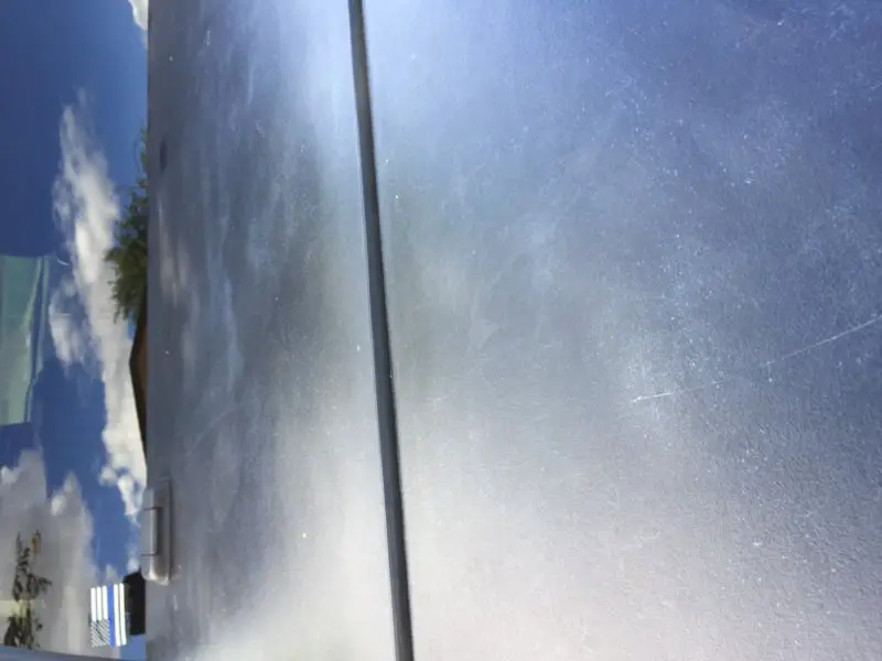

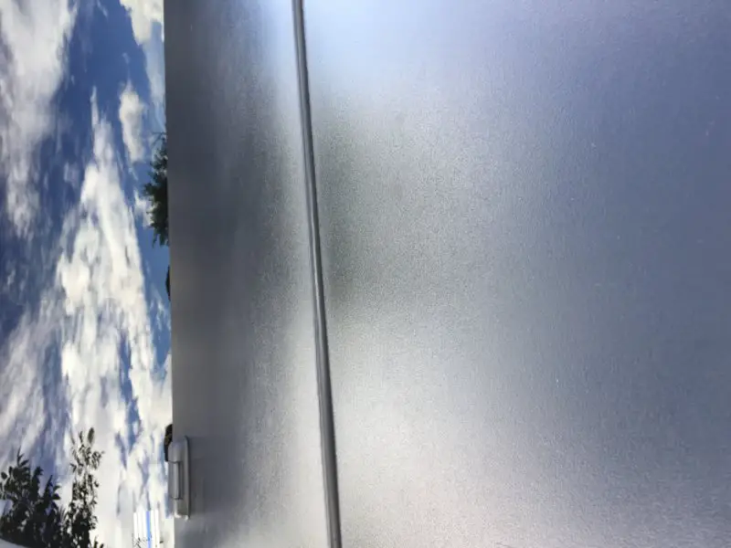

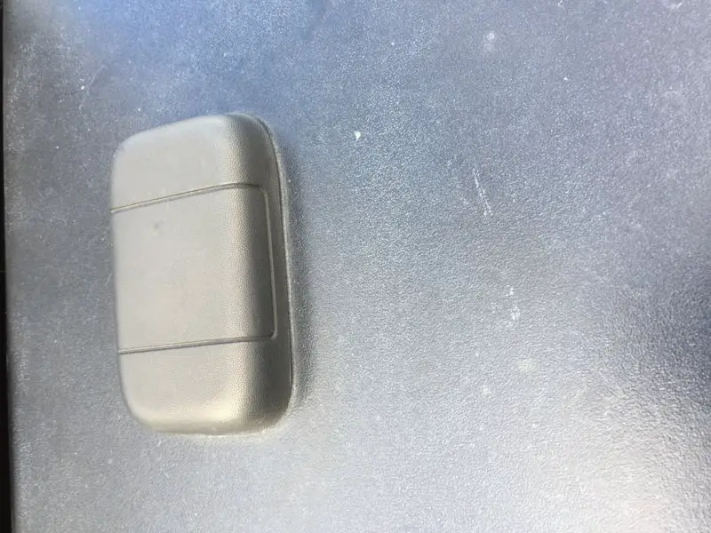

Some kind of cloudyness going on with the tonneau. 99.9% sure its remnants of Liquid Glass paint sealer I applied a few years ago. I've tried meguiars ultimate compound, turtle wax polishing compound, clay bar, scrub brush. You name it. Truck is garage kept, washed regularly, so not oxidation. Father in law paints cars for a living and had been talking to him about getting this repainted. He wasn't sure what was going on with it and wanted to sand a test area. My biggest concern was he'd want to sand it smooth. So its been an ongoing issue I've tried to avoid.
So I decided to try a Mr Clean Magic Erasure and thought I'd share the incredible results. More significant in person, it was sunny outside and the phone just couldn't handle it. Little more pressure than wiping, but not exactly rubbing. Couple of strokes in one area and the trouble disappeared.
Before:
Rear half done:
Both lids finished:
Couple more:
Whatever the junk was, again I'm assuming paint sealer, was mainly in the crevices around the orange peel texture. Easiest to see in these last two before & after:
