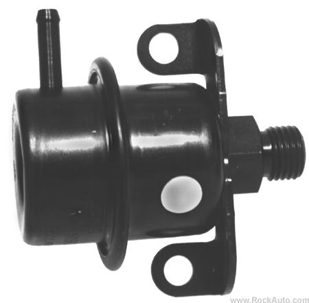

returnless fuel system
Your 1999 has a returnless fuel system with a fuel damper on the fuel rail and the fuel pressure regulator (FPR) in the fuel tank. The 1997 has a return fuel system with a fuel pressure regulator mounted on the fuel rail. I don't know if the return fuel line connects to the fuel pressure regulator or the fuel rail. Also, the 1999 fuel pressure damper may not directly bolt to the 1997 fuel rail. I suggest looking for a 1999 thru 2001 fuel rail. Below is what Rock Auto shows for a 1997 FPR.
I rolled the dice and went out there-- the fuel rail is actually the same. The only difference is what connects to each end of it. After the PITA 1 hour removal job in the 15* temps and wind, I'm glad for that. Now to get the thing buttoned back up and on the road...
