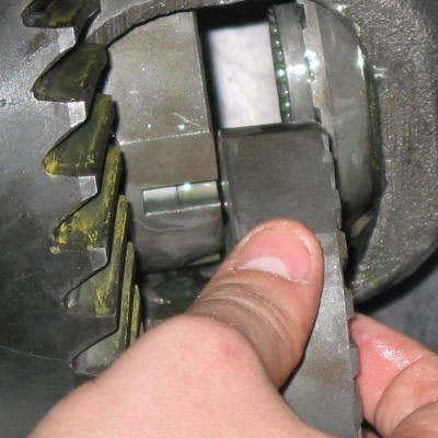

direct bolt in with use of a dremel :) on the other model for the 2gen's :) after all i was the test duy for that and its still great... heck i spent 8 hours to pull the front diff and check all clearances today.. still at the install specs

attachment.php
The XD13535 is shown. Torqmasters deemed that model unusable with the TTB35. They are now using the smaller XD13527 if i read correctly.
But, i still got a nice looking locker out of the deal, though!

mine wasn't bad like that.. it just wouldn't fit though the window in order to install it.
