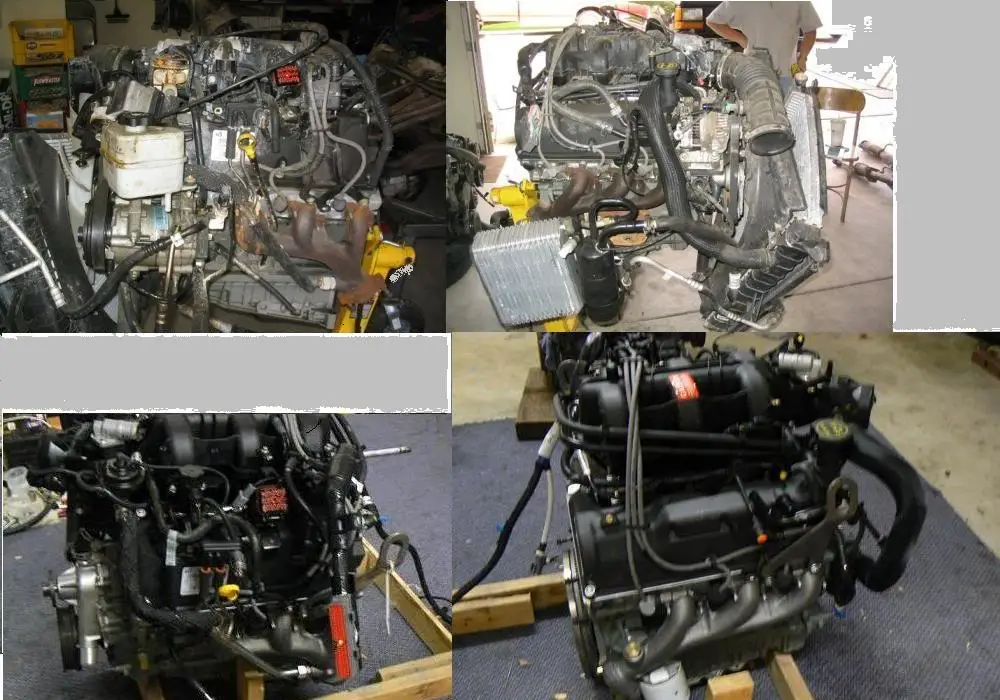

Well after searching and searching this sight I found out that the motor I bought is for a 2004 Ranger manual not an
auto explorer. Well at least I have somewhere to start now.
The motor on the top is from a 2004 Ranger, the motor on the bottom hasn’t got the alternator or aircon on but they are the same.
The two wiring looms are different .The biggest difference is the injectors and how they are wired up.
I'm going to try and combined the two wiring looms and if I can’t wire the injectors correctly I’ll just swap the injector
rack over from the old motor and buy some new injectors to suit the loom.
All of the sensors seem to be the same, the only on that I can see that is different is the crank sensor.
I’ll keep posting my progress on this as I go.

You are right all the sensors are the same plugs. Except the injectors.
Now that I’ve compared the two looms the task is not that difficult. The easiest way to go
would be to completely swap the old motors parts
Two piece manifold
Tappet covers
All plumbing pipes
Injector rack
wiring loom
And old injectors

I’ve pulled the manifold of the old motor and found a crankcase breather, which is not on the new motor. There was a plug in the hole where the breathed sits. I removed the plug, cleaned the breather an installed it.
I placed the old wiring loom in position. The injectors are wired different and there is an extra sensor in the block. I’m going to try and keep the new injector set up. So I’ll change the wiring to suit. I’m going to change the manifold rubbers but over here they cost a fortune so, I’ve ordered some from Click On Auto Parts. So now I wait. :thumbsup:
I’ve changed the manifold, rewired the injectors and changed every thing that needs to be changed over. Now I have the motor in the engine bay but I can’t seem to line the gearbox up to the flex plate on the motor. There seems to be no room to drop the motor into place on the engine mounts with out moving the gearbox back.
Is that what I have to do to get the motor to fit? Or do I have to leave the engine mounts off, drop the motor in and then try and install the engine mounts later. There doesn’t seem to be enough room to do it that way. Could some one please let me know the right way to do it is.
It is a 1999 XLT 4lt SOHC 4x4 5 speed auto.
Had the motor in for about a month now , but I just can't seem to get it to idle right. The mechanic has done a computer test and nothing showed up. I went for a long run and now the engine symbol has lite up. So its back to the mechanic for more computer work. I suspect the MAF is not right. Not a lot changes when it is disconnected, I'll give it another clean this time with contact cleaner, I searched the site for info on MAF and found more than I could read. So I might get that tested first.
