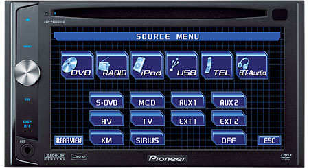

is it true all i have to do i ground the Green wire from avh p4000dvd to use dvd while vehiclel is in motion , OR do i need a normaly closed push button switch to ground to do this ? EX : push button when unit is turned on then let button go so its grounded and unit thinks parking brake is on , i know there are automatic ones out there im wondering how they work maybe i can make myown . thx
Hey! Thats a great-looking HU! Great price too!

thanks !!!! seems easy when i get it installed in my 03 eddie ill post some pics
well installed just ground the green wire through a N.C. pushbutton switch to ground when nag screen pops up push button wahlah works !!!
