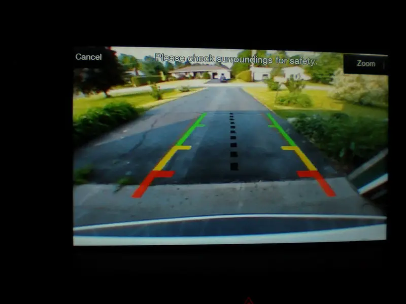

See this thread and the first post in particular; http://www.explorerforum.com/forums...-disconnecting-negative-battery-cable.427676/ I suppose you could try toggling the Active Lines setting a few times to see if that might help but if it is the camera going bad then I doubt anything would help. Attached is a picture of the camera from my previous 2011 Limited. The "Zoom" button is in the upper right corner.

The image is not inverted, shows regular footage, even when I zoom in so maybe the camera is just failing at this point. $300 is not awful either should that be the case. Thank you!
Peter
I just noticed the zoom feature this morning, guess I just never paid close attention to it this morning. I'll give the active lines a try and hopefully that works. Thank you!
