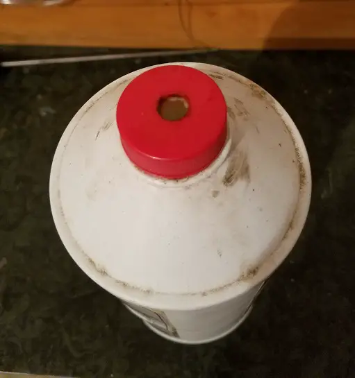

Wanting to pull some of the existing and dirty-ish fluid from the reservoir and not having a turkey baster, I used and old quart sized bottle from brake fluid and drilled a hole in the top. I had to put a wrap or 2 of electrical tape on it but it fit tight enough that I sucked most of the fluid out of the rez in 2-3 attempts.

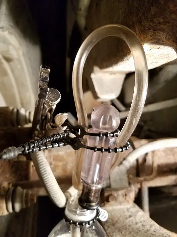

I should've used a longer piece of tubing as mine kept wanting to fall over and I had to sit my bottle on a gallon jug to get it closer to the bleed valve. My clear tubing fit pretty tightly but I didn't trust it and used a small cheap-o locking pliers and just turned it right along with the 9mm wrench. My first go at the farthest wheel I had air bubbles but once I got going no bubbles and fluid flowed clearer after several pumps.

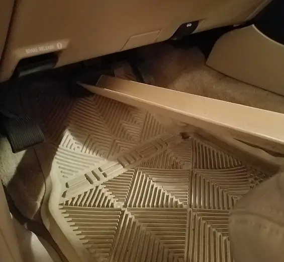

I used a stiff piece of card board to hold the brake pedal down after pushing down slowly. Closed valve. Released slowly. Checked reservoir level every 2nd or 3rd time and topped off as needed. One pump doesn't seem to pull that much from the rez.
