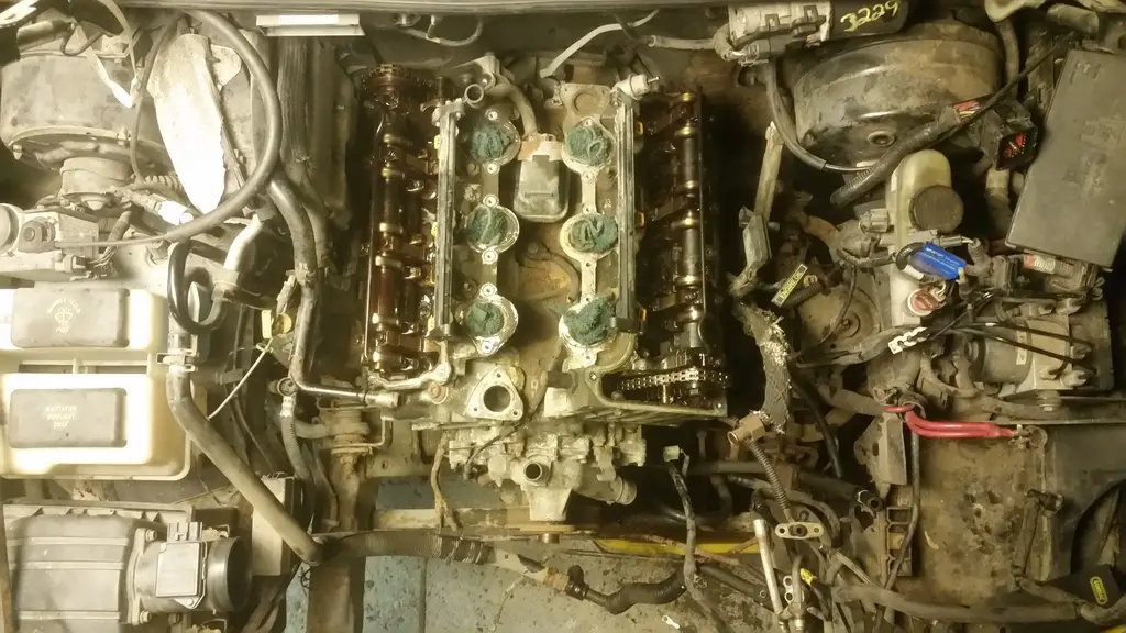

So I finally have a garage, and I've made time to start breaking down the 4.0 that had a crank, no start..
So far I'm down to the fuel rails and exposed the intake valves.. none move while engine is cranked and I have fluid on the tops of 5 valves..
I've taken pictures of every connection, electrical, and vacuum.. I also took pictures of parts coming off to make my own "rebuild manual"
**My question is this.. being a timing issue, and the valves are not moving, which chain should be the cause??**

More than likely your engine is toast. A rebuild probably is not economically feasible at this point. Once a chain breaks the valve hit the pistons ruining all kinds of stuff. If you want to keep it on the road, consider an engine replacement.
I agree with Koda.
Your best option sounds like a reman engine.
I at least want to see what's going on, it's the perfect opportunity for the 5.0 swap.. Depending on the amount of carnage I'll likely go with a salvage "get-r-goin" engine until this time next year when the inspection runs out..
I was ultimately hoping for a personal rebuild, that way I know what was done and at what extent.. I'm very mistrust in when it comes to anyone putting fingers on my vehicles..
To answer your question, if you are looking at the valves, you are also looking at the cam timing chains, so, if they are not moving, then the jackshaft chain or sprocket is no good.

First picture after intake removal..

Thirty pictures later I am only at this point..

Found this under drivers side valve cover..

Made some progress today..
