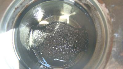

Most of the contaminants are trapped in the caliper reservoir behind the bleed screws. Compress the pistons all the way to get rid of most of it. Use a small glass jar and you will be amazed what comes out.
My pads have a little life left in them, but when I replace them, I do plan to have the bleed screws open when I compress the pistons. Good to know that will flush more debris out. Thanks.

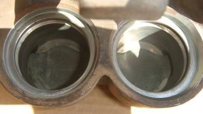

Here's a pic of my front caliper bore(s). I flush every two years. Nasty stuff.
