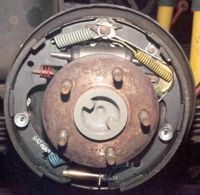

get the Brake line off the back, two small bolts from the back and it will wiggle out there between the axle. That horizontal thing under the top springs is what you are shooting for
