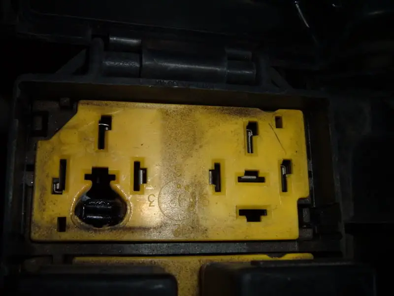

Go to the relay box on the passenger side fender, and pull the big black relays and make sure of of them isnt melting.
Mine did it and there was burning smell for sure.

Something else to consider...
This is why I said check the power box...my blower motor relay ate the yellow plastic thing on the bottom.
