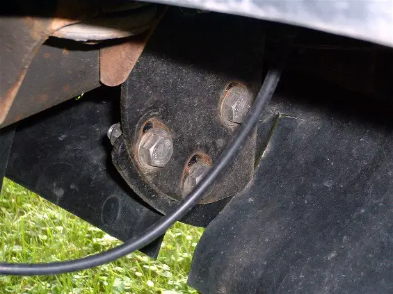

Yes, you do have to cut two slots in the lower airdam for the Manik guard to fit. Heres a pic showing the guard mounting bracket from the right wheel well. You can see the cut out you will have to make on the airdam.

explr1~ Thanks for the photo.... Is it a big deal to cut the bumper? I just wanna know if you will be able to notice the cut in the bumper, I really dont want it to look bad. Do you by chance have a picture from the front? Thanks buddy.

This is the only front shot I have now, not really a close up. You don't notice the cuts at all from the front though. The Westins don't require cutting the airdam, but they also hang down lower, and can get hung up on things offroading.

Get the manik, you will have to make two slits to allow the brushguard through, honestly like this wide | | get the westin, and it will hang down past the airdam, so you will have another low point, but no cutting. The choice is yours.
