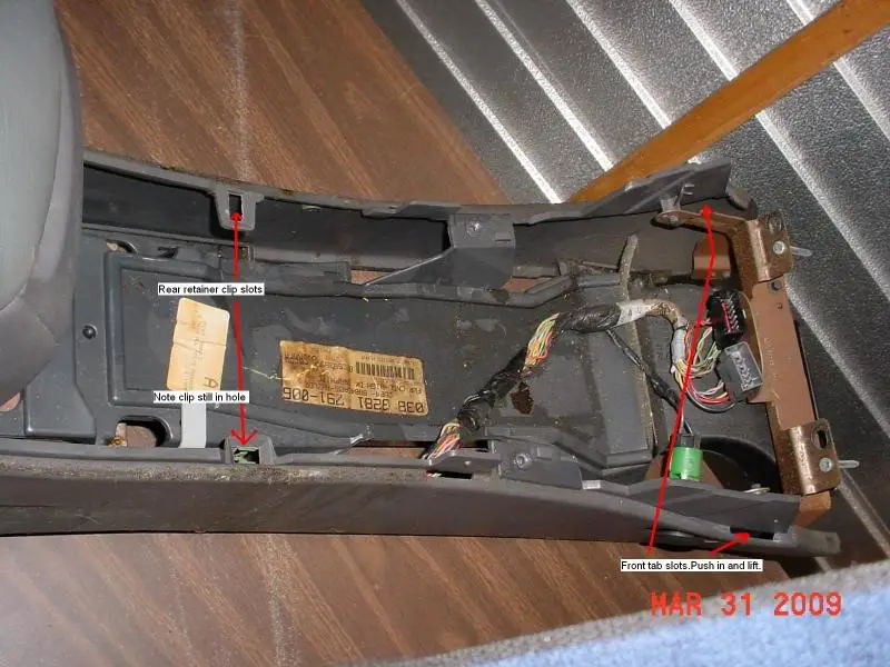

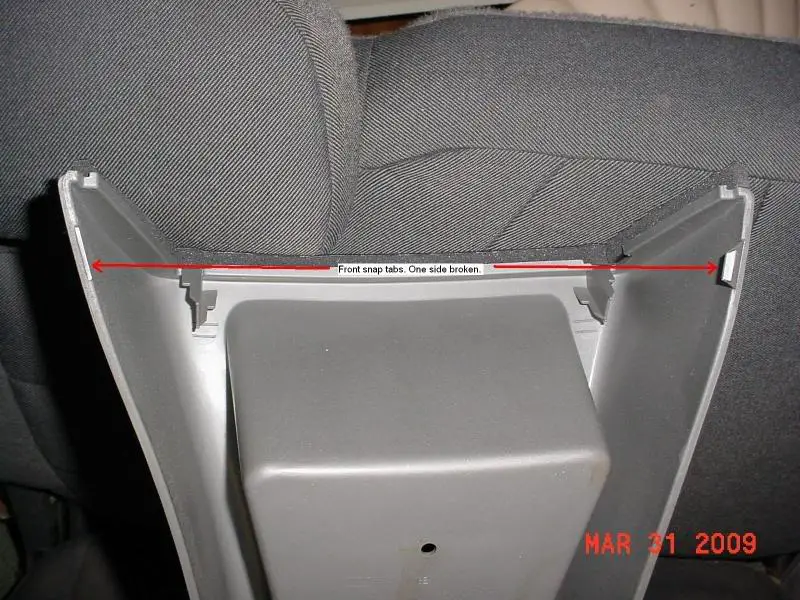

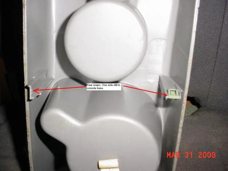

im trying to rmove the part that has the cup holders and the little storage spot on it but cant figure how to get it off
Push in on the sides at the front and lift at the same time. The back just pulls up. It's not the easiest thing to get off.
Edit: picture's worth a thousand words.

I am working on cleaning up the interior of my 2002 sport trac. The picture and info from ncranchero was very helpful AND I was was able to actually remove the center console successfully.

The part you want to paint of center console just pops out, just pull up on the cup holders. The radio bezel comes off by removing the 2 screws above the HVAC controls. Just pull it out after you remove the screws.
