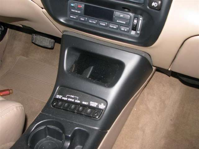

The overhead console does not display fuel economy. Some explorers came with an additional display that is at the front of your center console underneath your radio and heater controls. This is the display that displays your fuel economy.

Here's a picture Mountaineergreen posted in a thread about center console removal of the message center.
If your explorer does not have that, or something aftermarket added on like a scangauge or ultragauge, then you don't have anything in your truck that will display fuel economy.
