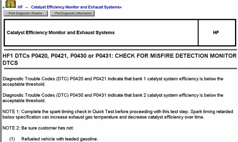

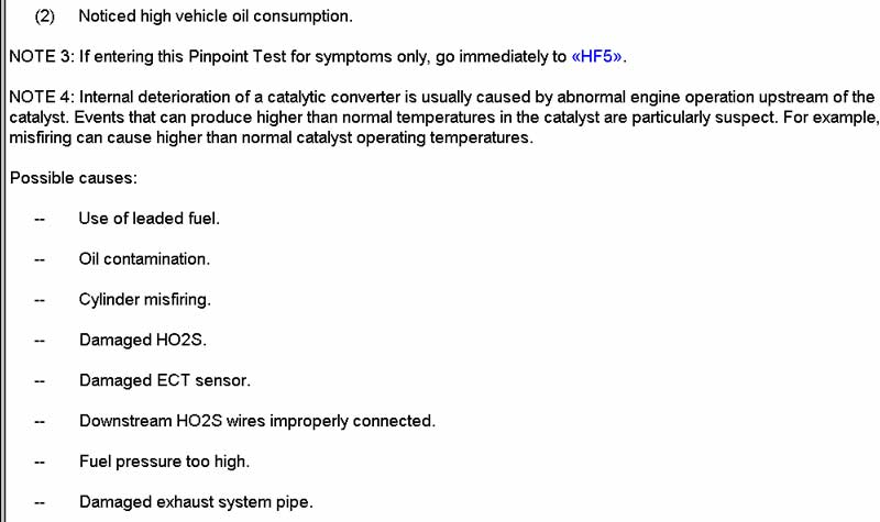

Hopefully it is the O2 sensor, but this code is supposed to indicate that the catalytic converter is not working - the O2 sensor after the catalytic converter is not sending the correct signal.
