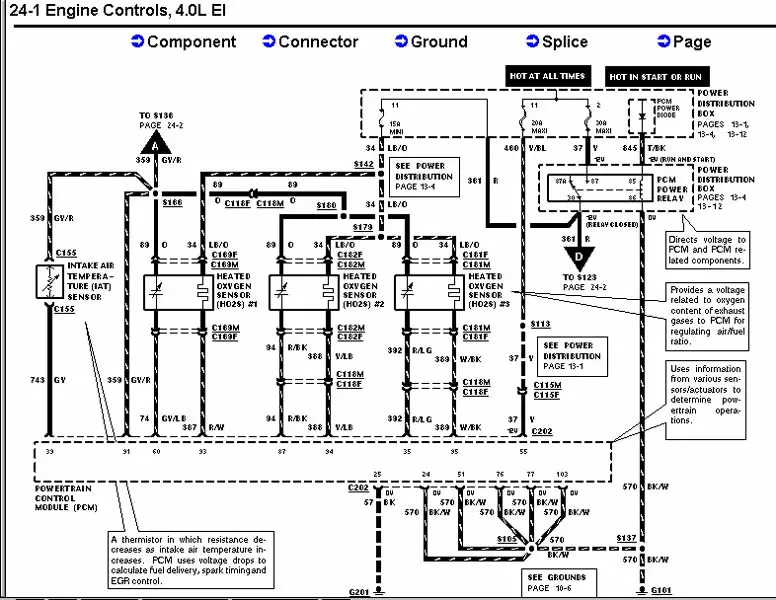

'96 XLT with DTC's P171 and P174 (running lean). My rig occasionally hesitates at idle and has trouble accelerating. I went to check the O2 sensors but am having trouble understanding the Chilton's manual.
The Chilton's guide says to check the HO2S wire and Signal Return (Grnd.)The voltage reading should fluctuate between .1 and 1.1 VDC. But the manual gives no picture of the wiring on the sensor. Can anyone help me out with which of the four wires is the HO2S wire?
Any tips on how to test an O2 sensor would be appreciated. Would it be easier to strip a small section of wire on the sensor to hook a lead too? I don't feel like blowing $80 to fix something that isn't bad.

This schematic is for a 97, but the wiring should be very similar.
For the 97, the signal return is Orange; the signal wire is Grey w/ Light Blue stripe for O2 sensor #1, Red w/ Black stripe for O2 sensor #2, and Red w/ Light Green stripe for O2 sensor #3.
Your colors may vary. ;)

I would offer my 2 cents to clarify this O2 issue. First, you can totally ignore the 'downstream' O2 sensors. Those are the ones after the cats. the only thing those sensors do is check to make sure the cats are actually in place.
You want to concern yourself with the 'upstream' sensors -- those closest to the engine (between the engine and the cats).
Second, you did not mention how many miles were on those upstream O2s. Hopefully the flaming will not get too bad, but here goes. Those upstream sensors should be replaced after 35k+ miles of use and certainly after 50k. The problem is the sensor may not have failed completely and thus failed Chilton's voltage test. What does happen after being subjected to the harsh environment of corrosive exhaust gases and high temps is that the sensor doesn't react nearly as quickly as it did when new and isn't sending information to the pcm quickly enough for the pcm to keep engine properly tuned.
The O2 sensors can be checked, but you need a scope to check how fast the sensor is reacting -- something most of us don't have. Replace those upstream sensors with Bosch sensors - about $50 each. Dealer charges about twice that much. The reason most folks don't change them is that large price tag.
You mention cleaning the mass air meter. A dirty mam can also cause tuning troubles. I assume you also have a fresh set of plugs installed. Do yourself a favor and change those upstream sensors. I just ordered a set myself for my 03 explorer.

Well, actually that's overstating the case. A scanner can show the voltage change, as can aftermarket O2 testers (I tried to sell one on here for $60 and had no takers). The "crossover" rate (how frequently the sensor voltage crosses over .445 volts in either direction) should be around 8x per minute, something the human eye is able to see. So you really don;t need a "scope" per se.
