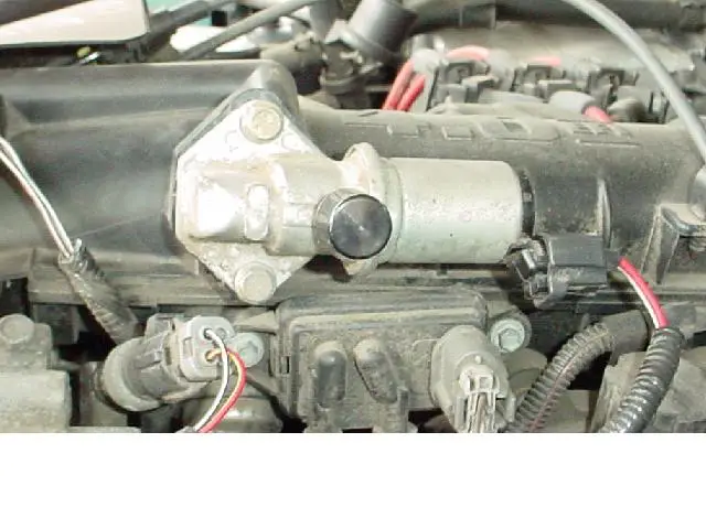

Here's the locale:

hey Hartman which black cap did you pull off is it the thing that you can turn facing to the driver's side of the car (or the black nob facing you in the picture above)and if so how did you take it off when i tried it didn't want to budge and i stopped, i didn't want to break anything. Also for an iac valve try ebay, i can't trust it being new but it is WAY cheaper.
I'm talking about the cap shown in the pic above. Mine just pulled straight off. I'm not even sure what the function of the cap is, but it solved the problem for the time being.

My truck had the whistle / honing, so I popped the hood, pulled off the black cap, and the whistle / honing dissappeared. Not sure it's function, really.
Also, since the two appeared to be related, I started my truck once, and it was NOT whistling / honing so I popped the hood, and tried to induce the reaction by covering the hole. No luck.
