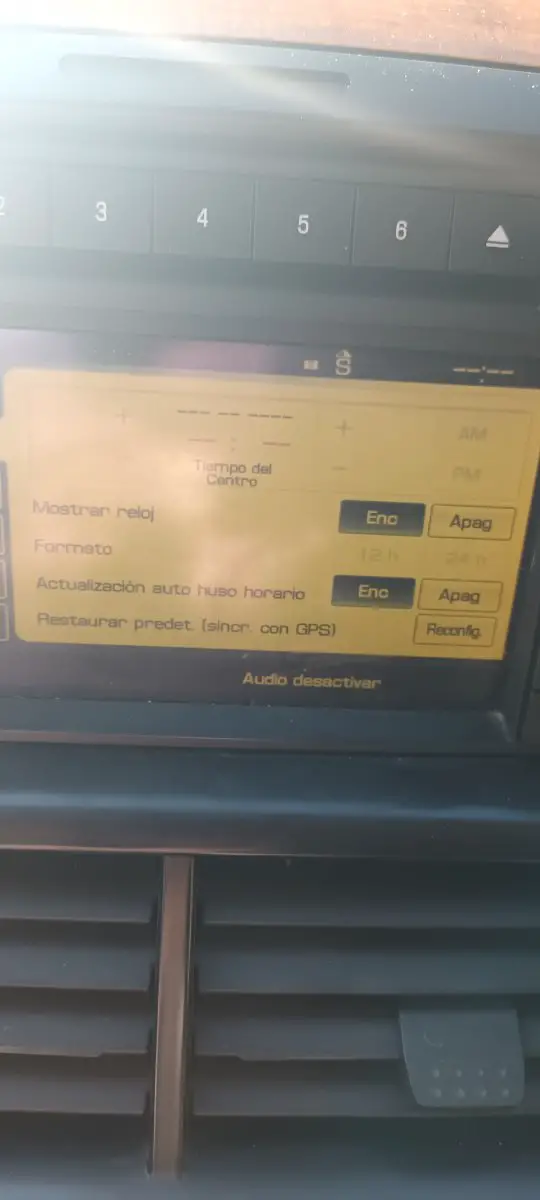

-After getting the car fixed because of a crash the clock just wasn't working (like in the first picture). The calendar still showed the current date at that time.

Are you connecting a smartphone to it? If not this might be necessary for it to set the time. Or it has to be done manually. This might be happening because they are disconnecting the battery for a long period of time. This resets the PCM and other systems and might be clearing the time setting. Mine resets the time when it connects to my smartphone.
