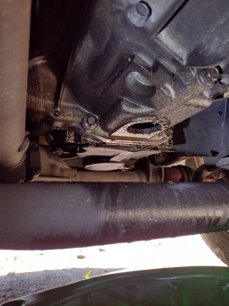

I've had a bearing noise coming from the bellhousing, and it would go away when I let off the clutch pedal. I assumed I had a clutch release bearing going bad.
Today the clutch pedal went to the floor and I couldn't shift. Getting home was fun. I checked underneath and I'm leaking fluid through the hole in the bottom of the trans. I assume something to do with the clutch slave assembly blew out, and I'll be pulling the transmission, correct?
