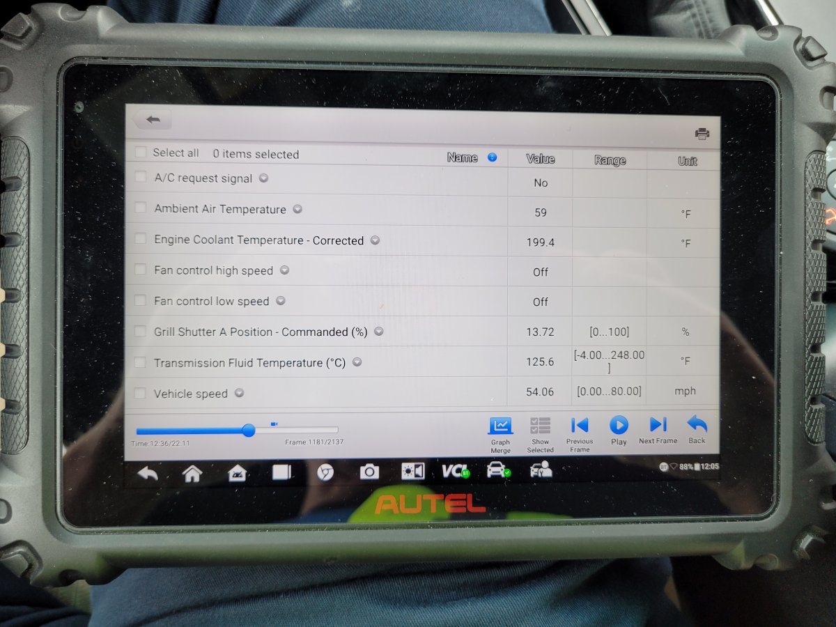

Alignment of actuator prolly not. The upper and lower grill shutters are not in sync. Grill shutters on a scan tool have a value of 0 being closed and 100 fully open with yours likely not hitting the zero number.

I would like to know the values on a scanner 1st before proceeding.

I posted the video link and the bottom closes completely while the top is disconnected. The learned limits should have been erased by now, since I disconnected the battery yesterday when I replaced the spark plugs and had to relearn the idle and driving habits. I'll show a video of the forscan reading the values for the shutter. I'll cycle the ignition a couple of times before starting it and I'll leave the top shutter disconnect also.

Here is the forscan grille command. I unplugged the actuator, connected the bumper, cycled the ignition 3 times, reconnect the actuator, left the top shutter disconnected and setup forscan. Video link below
I was looking at the video and noticed the fault was there immediately for the End stop not found.
