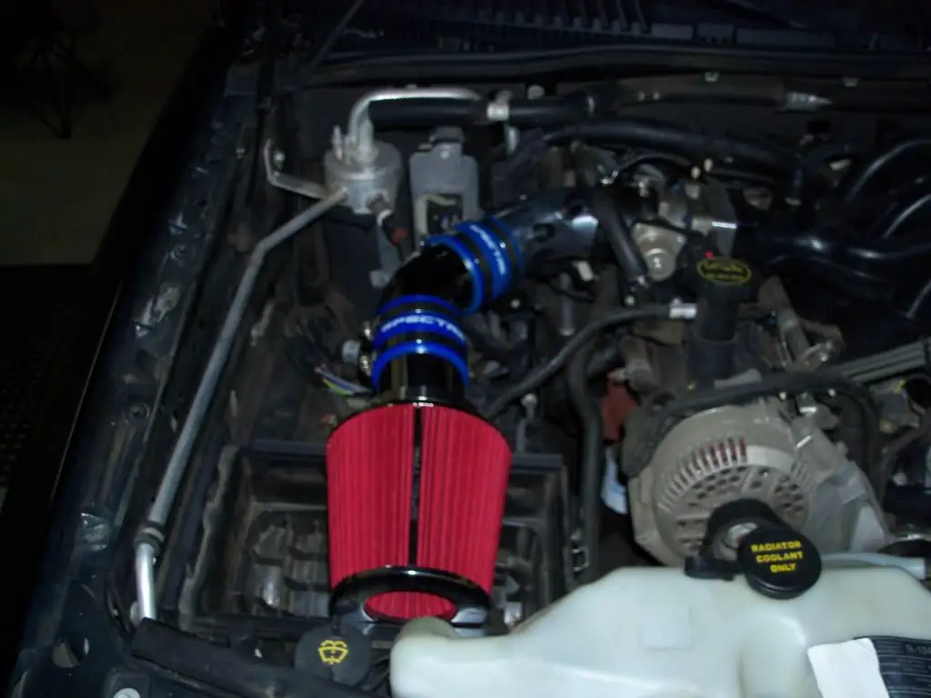

Okay I ordered the cai for my 08 explorer 4.0 v6 will I have any problems with the cel light or what. And I don't have to get my ecu reprogrammed do I. And also has anybody used this kit before what your reviews.

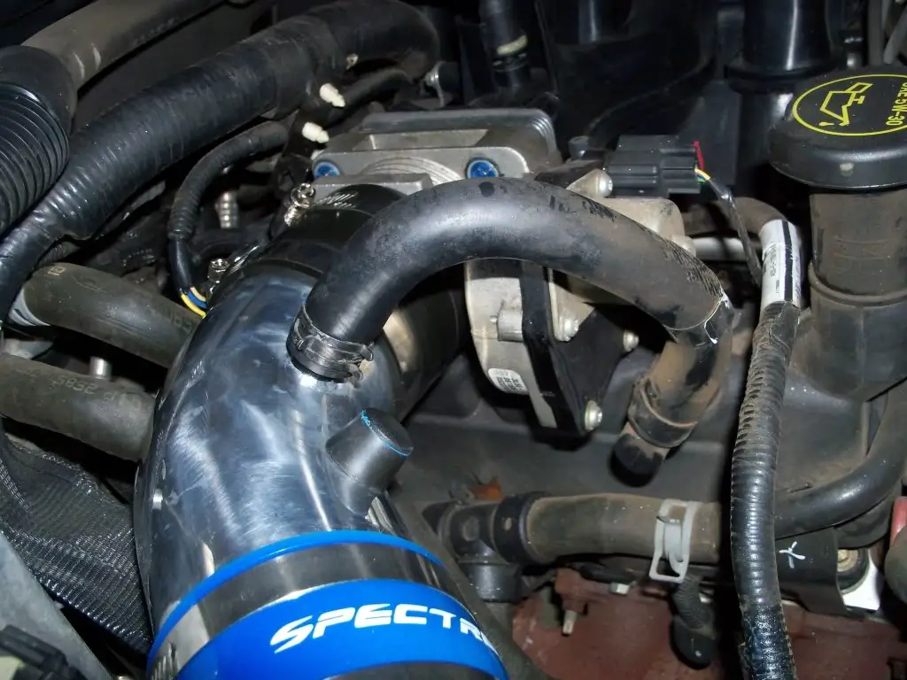

I have an '07 ex, and I had no problems or lights with anything. I use the KKM CAI. The only thing I noticed and no one has given me a solution, and I have torn the car apart myself looking for a solution, is a wierd whistle at about 2500 rpm. it is not I REPEAT not the fault of the CAI, the noise is there and can be heard with the stock intake, it just masks it really well and you have to have your ear in the engine compartment to notice it. With the CAI it is much more open and you will here it. I have moved, replaced, and adjusted lots of stuff and pretty much came to the conclusion that it is airflow into the the throttlebody that causes this. If anybody else has any ideas I would love to hear it.

The whistle you guys are hearing is being caused by the IAC located somewhere on the intake. Varies with diff. models. Check out this link for pictures and ideas of how to clean it. A new one is around $80 and really thats the way to go. I've cleaned mine several times and the whistle always returns.
http://www.explorer4x4.com/iac.htm
HOpe this helps.
John
I got mine at autozone, it cost me 90$. And it most of the time when you put a cold air intake on and the "Check Engine light" comes on its because the engine is running lean, because there is a leak in your intake. If that happens spray soap and water onto your intake tube, where ever you see bubbles, tighten up the hose or clamp.
